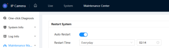

Hello,
I recently purchased an IPC-Color4K-X S2. The camera works fine but I have noticed that the Auto Restart of the camera takes about two minutes when all of my other cameras are a few seconds. I'm curious to know why this camera takes so long to reboot? Has anyone else noticed this?
I have Auto Restart set to daily but I may change the schedule to once a week. What do you do?
New Camera
2026-01-19 2:14:37.753 AM Cam9 Signal: network retry
2026-01-19 2:16:11.088 AM Cam9 Signal: restored
Typical for all my other cameras
2026-01-19 2:11:10.133 AM Cam5 Signal: network retry
2026-01-19 2:11:12.952 AM Cam5 Signal: restored
Or if not BI it could be Firmware.
A number of the FW versions had odd habits.
One of mine on reboot always changes the bitrate to 8192 (I set it at 16,384)
Reactions: MarkusAgustus
"It must be when BI is detecting the lost signal and retrying the network.
None of my cameras take a few seconds to reboot."
I believe you are correct. I went to the raw footage on several cameras and they all do take longer. Case closed, thank you everyone!
