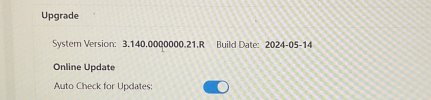

Not sure if this thread is dead but I have the Color4K-t180 and can’t get the IVS to work using either the NVR or camera. This is paired with the NVR16CH-16P-2AI and have other cameras from Andy working with IVS rules on this same NVR (T54IR-AS-S2).
The FW on the T180 is 3.140.0000000.21.R with a build date of 2024.05.14 which looks like the latest version but to be honest, it’s a bit confusing on what is the latest.
Can anyone offer any advice as to possible solutions for getting the IVS running?

Regarding the firmware for the camera, I have two T180 cameras, and I am using the firmware Andy has posted on his site (2023-12-24) revision 7, but I see that there is a newer firmware for the camera listed on the Dahua site (2025-07-18) revision 25. Here are links to both:
Andy's site: Download Firmwares
Dahua's site: IPC-PDW5849-A180-E2-ASTE - Dahua International
Note, I updated my cameras to the newer Dahua firmware (2025-07-18) revision 25 just now, and they seem to be working fine.

Thank you for the links.
Just updated to the Dahua FW and in the process of factory resetting 3 times
Will set up IVS again and hope that it works now. Will post my findings.
