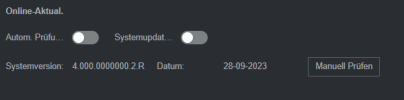

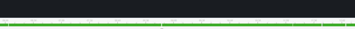

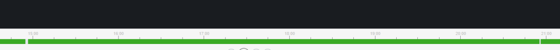

Hello,
I'm having a problem with my new NVR and the three cameras connected to it via a PoE+ switch. Every now and then, about a minute of continuous recording is missing. This only happens with those three cameras, not with the ones connected directly to the NVR ports. Has anyone else had the same problem

The only issue I'm having is with the cameras connected via the switch. The others, which are connected directly to the NVR, work without any problems. What I've noticed is that they sometimes just reboot on their own. I'll run some tests tomorrow and hope that fixes the problem.
