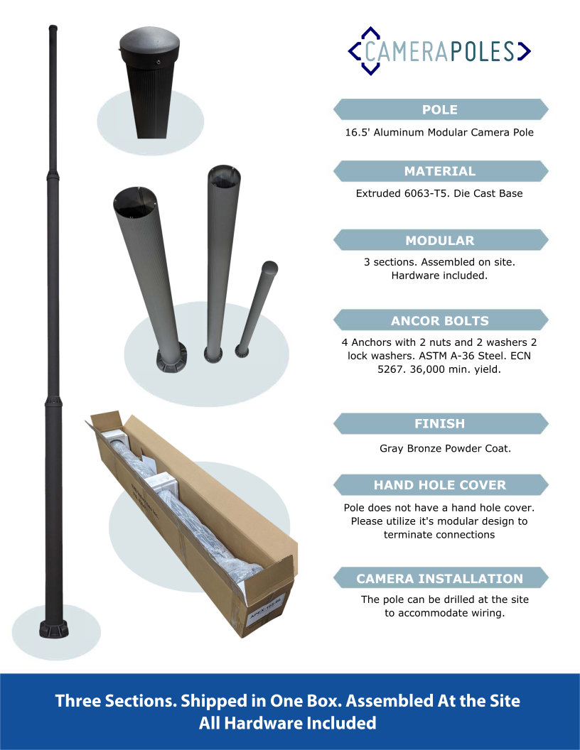

Found this thread when looking for a pole mounted camera system. Has anyone ever looked into or used the one by Viper Security? I just reached out to them for more info. Its on their website about half way down the page Here.
