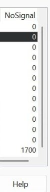

In a weeks time the IPC-Color4K-T180 has had no signal 1750 times. This has been happening for the longest time. What is the problem. I have run brand new wire, I have tried multiple switches, I have tried just a stand alone injector. I don't know what else to do. What is wrong with the damn camera?? Do I need to talk to Andy? Has anyone else experienced this? If so, did you see the same problem? Were you able to fix it?

No, there is a PTZ that this happens to also, but that is only during when it is cold outside. When it warms up, that problem goes away.
This problem with the no signal on the 180 camera has been going on since the beginning. I just hadn't noticed it before because it didn't happen as often. Now, it is going crazy.

No, where it is installed.
Keep everything the same, but swap the camera, to rule out everything in between. And then the same with the trouble 180 where the other camera was.
Yeah, I could do that. The problem is that this camera is almost 20 feet high, in a tough place to get to. The thing is, I have seen where others have had a problem with this camera.
Well, I switched it out with another camera, and not one no signal message.
You're telling me I could have saved myself climbing a ladder almost 20' high just for the click of a box. Damn it. I'll hook it back up again tomorrow and check the box and see what happens. Let's cross our fingers.

Well, probably! I also had tried many things, mostly regarding the ethernet cable, with no change till I read this thread:
That one setting allowed me to go from dozens or more connection errors a day to none, and it's worked great since then. Bring back the ladder!
Well, it worked somewhat to check the box on compatibility. Now instead of 250 no signals a day, it has given me 2 no signals in 3 days. That is a big difference.
My PTZ that has a no signal issue still has a no signal once in awhile, as it has had 9 no signals in three days. I can live with that though.
