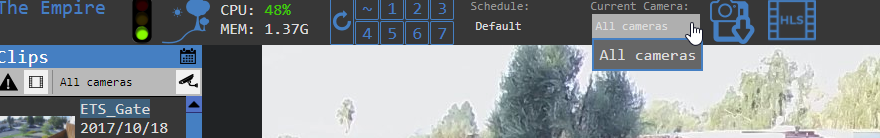

Can't Switch Cameras on the UI2 page
I can's seem to switch between cameras. The dropdown menu for cameras only shows "All Cameras", but it only shows one camera in the viewer.
I can see the clips to all the cameras, but not their live views, except one.
