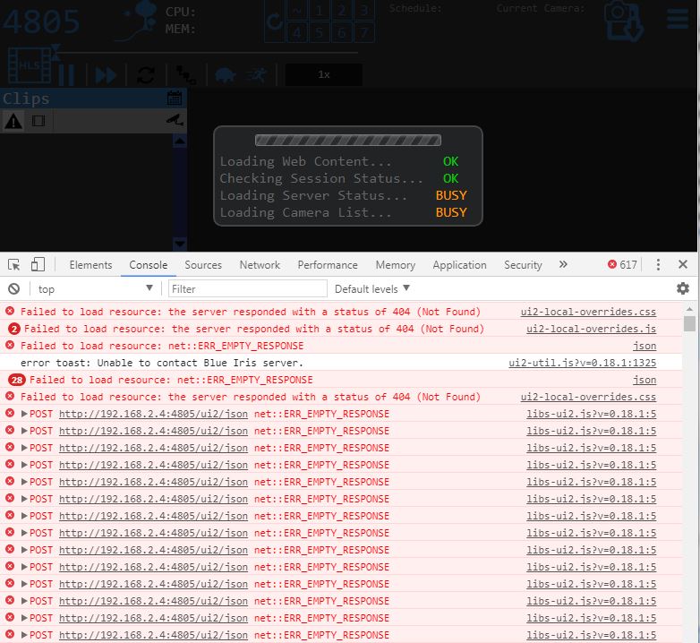

Updated from 17.4 to the latest version and I'm getting "Unable to contact Blue Iris server" when I load the page.
Was working fine before. I have the files in a UI2 subdirectory under the Blue Iris 4/www/ subdirectory (i.e. /Blue Iris 4/www/UI2/). I wiped everything in the subdirectory then copied new files in. Page loads, shows Loading Web Content OK, Checking Session Status OK, Loading Server Status BUSY, Loading Camera List BUSY, then just sits and spins.
The server is running. I can hit the regular /jpegpull.htm site fine.

Capture attached of the errors seen in the browser console. The POST errors just continue forever.
I think that I may be missing a file(s) or I've messed up the structure of where things are. Don't see the first .css file that's throwing an error (unless I missed it or I'm misunderstanding and it's part of some other called file, not really a web app guy). I do see the .js file by the same name but it's not found apparently and still causing an error.

This is due to a UI2 change, actually. A while ago I sacrificed UI2's ability to run out of a subdirectory in favor of making UI2 work with reverse-proxy servers that add a virtual directory to the path. I think I just realized an obvious way I can make both situations work simultaneously, but it will take a new patch to UI2 to make it happen.
In the meantime there are two ways to solve your problem:
1) Don't run UI2 out of a subdirectory.
or
2) Create a file "ui2-local-overrides.js" in the same folder as ui2-local-overrides-template.js and paste in it this code:
Code:
remoteBaseURL = "/";
which will let you run UI2 out of a subdirectory again.
The missing .css and .js files are intentional and harmless. The UI requests those files just on the offchance that you wanted to create either of them and use them to override UI2's default functionality.

Thanks. Adding the overrides file worked fine. I'd moved things out of the subdirectory temporarily but would rather keep things separate if possible just for general organization purposes.
I'd kinda forgotten how limited the default was. Once you go UI2, it's hard to go back.

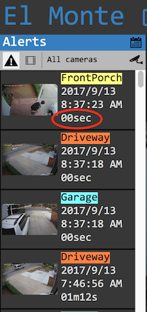

@bp2008 In UI2 (v0.18.1), I noticed when a new alert is generated, it gets "00 secs" as shown in the screenshot. The problem is when I try to playback this alert, it doesn't do anything, probably because UI2 thinks that there is 0 secs to play back?
If I wait a few minutes and refresh my alert list on left, I get the real elapsed times for these new alerts and playback functions as expected.
Any workaround for this?
BTW, I don't have this problem in BI mobile app, meaning, I can playback an alert right away.
I'm aware of this problem. UI2 will only play up to the advertised duration of an alert, because if I request an image beyond the actual duration of the file then it will loop around to the start again and make a mess of things. Not to mention the notion of playing past the end of a file is incompatible with seek bars. So this behavior isn't likely to change any time soon.
Blue Iris seems to update the alert length data every 5-10 seconds so if you keep refreshing you should see it change length and you can start viewing without waiting a few minutes. However it will stop early and you'll have to refresh the alert list again and start watching, seek to where you left off, and it is really not very easy to get along with that way.
The new UI I'm working on automatically updates the clip/alert lists, but I don't think I had it automatically lengthen the seek bar when the duration is found to have changed for the currently open clip ... so it will be a minor improvement but not a huge difference.
