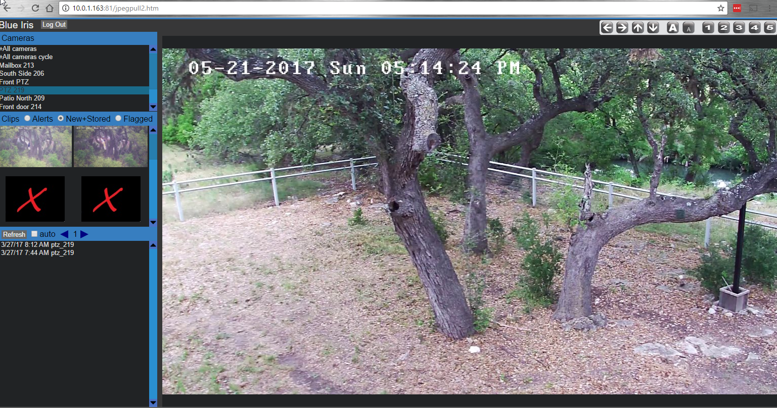

I've read through many pages and can't find the answer loading a page that looks like your examples. I get what looks like a hybrid of the two. Can anyone point me in the right direction?
