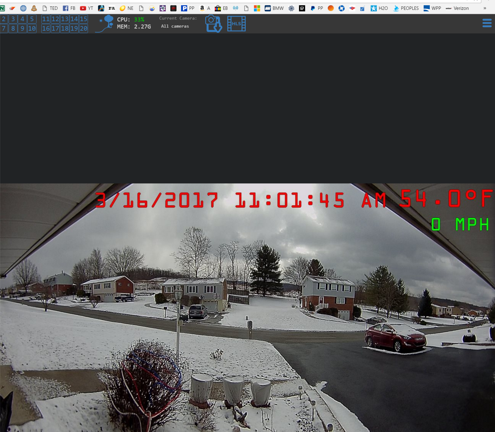

Another issue Im having I have 5 servers listed in UI2 and all work fine except for 1. When I pull the main page and it only shows me 1 camera? I can pull up clips and playback from "all camera" but it only shows the one camera view...tks agin in advance..........

Probably, you need to find the "Current Camera" label at the top of the UI, and just under it select "All cameras". Chances are you accidentally selected a group with only one camera in it.

I thought of that also but as you can see I currently have all cameras selected.....any setting I may be missing in BI? I even deleted the one group....
