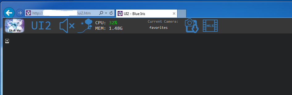

No video. Title bar only, since upgrading to 17.1
I'm thankful for the great UI that you have developed and am not complaining. I figure you are interested in the error though.
It does not happen on Chrome or Firefox. But it does happen on all of my machines on IE and Edge. If I can I'd like to use IE on my Win 7 machine because it is less impactfull on my CPU than Chrome and Firefox.
I just installed 17.1 and now the UI shows only the title bar. . View attachment 12571

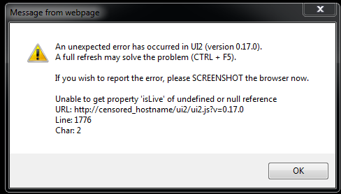

I was getting the error below in UI2 v 16.3 and in v 17.0. It was happening in IE 11.0.9600.18524 on Win 7 (V 6.1 Bld 7601 SP1. But not Chrome or Firefox.
Old error:
Unable to get property 'isLive' of undefined or null reference <url>ui2/ui2.js?v-0.17.0
line: 1776
Char: 2
I see that you are already on it. Thanks.
I was getting this error on Safari - Installed v0.17.1 and now just get the attached
It should be fixed now. Please report any further defects you may encounter.
v0.17.2 - 2016-11-18
* Worked around a quirk in some browsers preventing the session cookie from being sent with image requests that had crossOrigin="anonymous" set.
Old error:
line: 1776
Char: 2
If this is still happening to you with 0.17.2, I will look into it further. I looked at that line of code and I can't really imagine how that could happen unless something else failed during the page load.
Neither the old error or the session cookie error are happening any longer. Thanks again.
