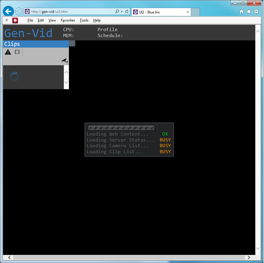

How can we tell if you have posted updates? Just curious if updates are made to this view and how/when to get them. If updates, features or enhancements are made I'd like to get them since I am not an HTML person I take what's given and I really like the ui2.htm interface!
UI2 error
BI 4.0.1.8 x64
Most recent version of updated files
Attempting to open in IE11
I always post a reply here when I upload a new version. That is currently the only system in place for letting people know about an update. Sorry! Maybe if there is a significant demand for it I will have to come up with something better. (you can always subscribe to this thread and receive an email when there is a post, but sadly most of those would not be me announcing an update.

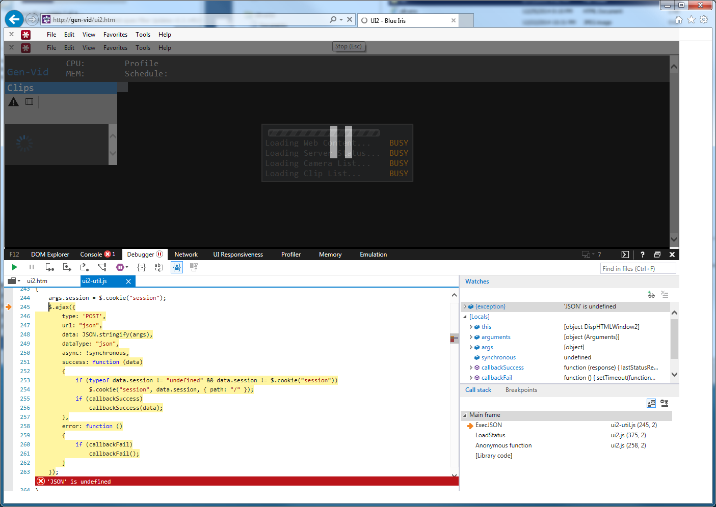

UI2 error
BI 4.0.1.8 x64
Press F12 to open the IE developer tools. Open the console tab, and then refresh the page with CTRL + F5 and see what errors show up. But I suspect at least one of the important javascript or css files is missing or corrupted. You might also try re-extracting from the zip file.
I have a similar issue on a fresh BI installation. Not using BIT, just the latest and greatest version of your files.

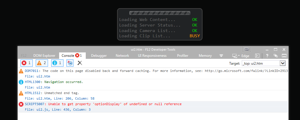

I'm getting stuck at "Loading Clip List.. BUSY" This is what IE reveals from the directions you posted.
attachment.php
Initially I changed the storage from C: default to D: as the default but switched back to default C: for troubleshooting purposes and get the same result.
attachment.php
That one is likely because you only have one camera.
Adding another camera fixed that problem. Thanks!
Is it a bug or just a requirement?
