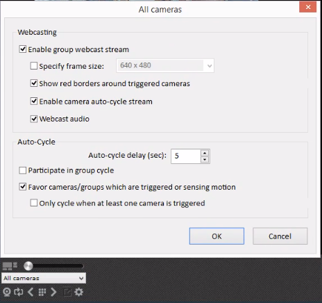

None of the camera cycles are configured in UI2 - that is entirely done in Blue Iris. After that, in UI2 you just need to choose a cycle in that dropdown list under Current Camera. If it cycles at the wrong speed, it is because Blue Iris is changing between views at the wrong speed, and it has nothing to do with UI2. Reloading the clip list won't help -- not sure where you got this idea from. By the way, you reload the clip list by clicking either of the two little buttons below the word Clips:
Anyway I'm on the latest version of Blue Iris and I can confirm the cycle timing is correct in this version.
Thanks bp2008,
I thought the setting I needed to change for cameras cycle timing was located here Screen Shot 2016-06-19 at 10.31.08 AM.png. But after your reply, I've dug a bit deeper in the actual Blue Iris and I've found where to change this: Screen Shot 2016-06-19 at 10.30.21 AM.png by clicking on the cog and then changing the seconds in the box from the screenshot attached.
Thanks for confirming this setting can't be adjusted via UI2 so I stopped looking there and found the setting in the right spot.

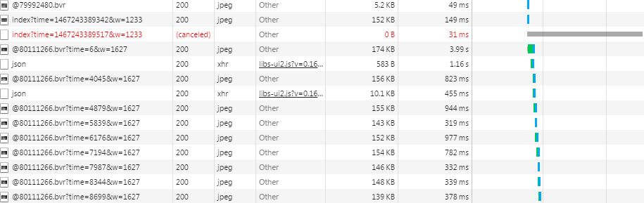

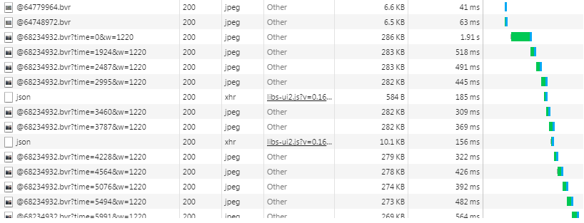

I have a problem caused by high load time of an initial clip image. I store everything but DB on Synology NAS DS215j with WD Purple 4TB, and the PC is connected via 100MBit Cisco router (unfortunate part of a cow milking robot solution - I am working on getting a newer gigabit model which is actually way cheaper :mad-new:, and also my notebook is quite slow). So the system has not a perfect performance and the result is this:
The first image takes way too long to load, and then it is immediately replaced by a second one, however the latency is not taken into the account so it can easily skip a half of the 10s clip, forcing me to restart the playback to see what actually happened.
I think it would be better to load the first image and then start the playback, not the other way around.
Also notice that the first image has not time 0 (not always).

What an unexpected problem! Normally the first frame doesn't take significantly longer to load than any other. Try turning off "Clip preview animation" under UI2 options > UI Behavior as that can reduce the burden on Blue Iris and it may improve the response time when it really matters.
I can't properly "load the first image and then start the playback" because when the first frame is loaded, it is immediately time to start the second frame. I must know what time value to ask for. Normally, this is simply the previous frame's time value plus the time it took to load the previous frame, but if I can't rely on the first frame's loading time being representative of the second frame's loading time, then what do I do? I can limit the time difference between the first and second frames, but then people with slow network connections would experience clips that play back at an inconsistent rate for the first few frames. Admittedly that would be a minor issue, but I think it would affect far more people than your issue.
The reason the time of the first image is not always 0 is that there is quite a bit of script being run between the moment when the playback clock is zeroed and the moment when the first frame is actually requested. I can certainly move the logic around a little to mostly eliminate the oddity, though it won't have much real-world effect.
