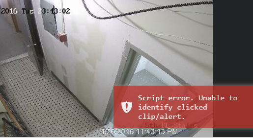

Hi great work with this new UI. ive been using it for a few months now and all been working fine but recently i get and error when downloading any clip except the first one. I really need this feature to work.
posted a screenshot below. It would be amazing if you or anyone else could help me fix this. Thanks!
https://drive.google.com/file/d/0B4J3dhCtMr3CbWhuVkdyUWFvdXc/view?usp=sharing bi error.png
Oh wow you are right. When I click on the older ones it works. Thanks!

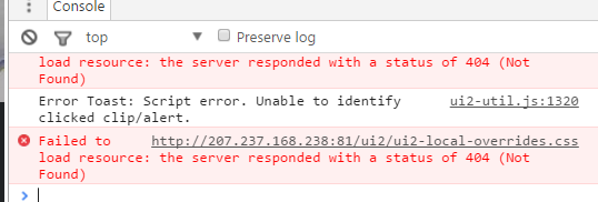

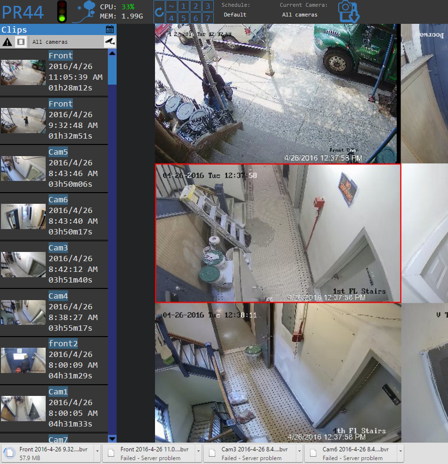

Im getting a different error now when trying to download clips or alerts. Its happening for all clips.
Oops. I must have broken this in the last update. Will fix in a day or two. Thanks for reporting.
I think I found the problem, but I am not able to do a release right now. Try opening the file ui2/wdContextMenu/jquery.contextmenu.js and replace its content with this:

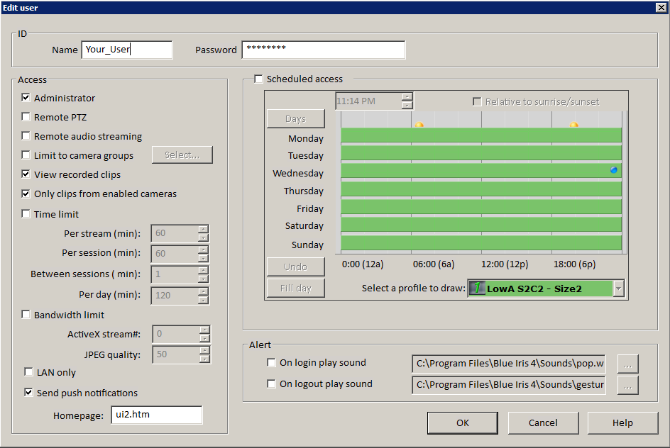

Im sorry if i missed it i tried search the thread and reading but 65 pages is toomuch, is there anyway to make this default page when loging in ?

Im sorry if i missed it i tried search the thread and reading but 65 pages is too much, is there anyway to make this default page when loging in ?
In Blue Iris, open the Blue Iris OPTIONS > USERS and select your username and then click EDIT. Under EDIT change Homepage to ui2.htm
