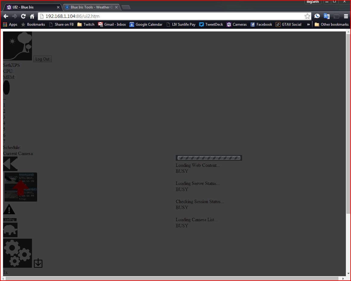

Recently I updated my files to go with the Blue Iris updates, and my ui2.htm now is not functioning properly. I've tried replacing the file manually and thru BITools and still have the same output (in the photo) Thanks for all you do bp2008 if it wasn't for your work I would not enjoy Blue Iris as much as I do! View attachment 8262
OK i'ma go hit myself upside the head a few times for that dumbness lol, the force full refresh worked thanks a ton bp2008CTRL + F5 to force a full refresh. If unsuccessful, re-download and re-extract everything (overwrite all files), then force another full refresh.
OK i'ma go hit myself upside the head a few times for that dumbness lol, the force full refresh worked thanks a ton bp2008![]()
