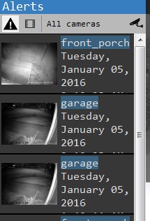

Question:
On the left hand column, where the Alerts are...the 5th line is cut off. I'm assuming that's the
time. Any way to make those fonts smaller so I can see all of the text...or maybe change the
date format?
Thanks
Doug
