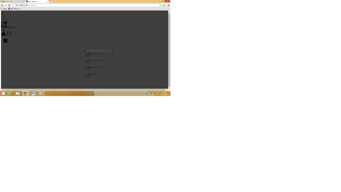

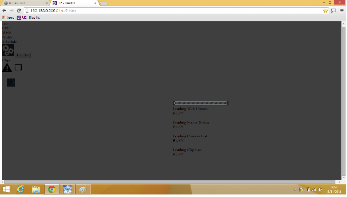

This is driving me mad. I had UI2 working perfectly (its fantastic BTW!!) , then i reformatted. Now whenever i connect locally or from an ip outside, i get this loading page. jpegpull.htm still works fine.
Anyone any ideas? I have tried overwriting the files again with a fresh version. no luck :(
edited to add that i tried http://localhost:81/ui2.htm and it works, but if i connect from the blue iris console using its ip, it doesn;t.

I'm confused. At what point is it working? Try ctrl + F5 to force a full refresh. Otherwise it looks like you are missing some of the files.
I assumed files were missing, but as i said, connecting to localhost:81/ui2.htm worked.
Now.. bizarrely, ever since i connected to localhost on my machine, it now works fine using the full 192. x.x x url on that machine.
my ddns is having issues, so i'll get that working and try it again from my work pc.
