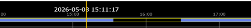

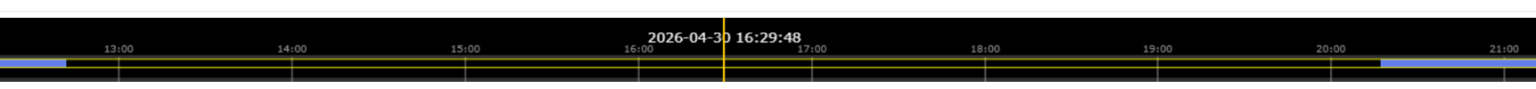

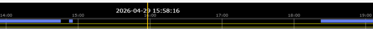

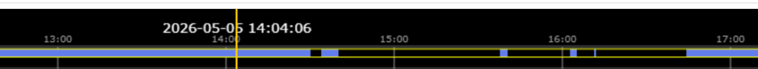

I've uploaded some images, 2 days from the past week have been fine, but the pattern in hours is roughly the same, no issues apart from these.
