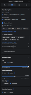

Mine stops working every night. Only way to fix it is to put the fps/bitrate to auto then restart the AI Port…

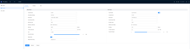

Would you be able to post a SS of your dahua encoding window. What resolution/fps/bitrate you running in the dahua camera
Reactions: Arjun
Sure,

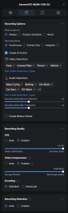

I recently when back to standard encoding in UniFi Protect due to issues with night-time LPR detection after a recent UniFi Protect update. Works very well now, and I cross-check with the AI Model in Blue Iris's LPR detection and Rekor Scout
Hmmm I’m wondering if the fps or bitrate is messing it up for me. Have it set to 60fps, 4k, 14bitrate. Runs fine during the daytime, if you download a clip in protect it’s also recording in same specs however every night, when it switches from daytime to nighttime recording mode it fails and doesn’t pick anything up unless I restart
