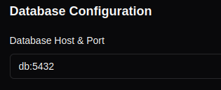

Your DB port is wrong. should be 5432, not 5433 (unless you did that intentionally)
that is correct port and it connects to the DB ok

a2acad44a76c postgres:13 "docker-entrypoint.s…" 36 hours ago Up 12 hours (healthy) 0.0.0.0:5433->5432/tcp, [::]:5433->5432/tcp alpr-db-1
Okay, looks like it is running but not sure why you have 5433 to 5432 port mapped. I run a few different instances of ALPR and by default, none of them do this. I'm on Linux, so maybe this is normal for Windows.
this is running on debian 12, i picked 5433 because years ago i had a testbed on 5432.

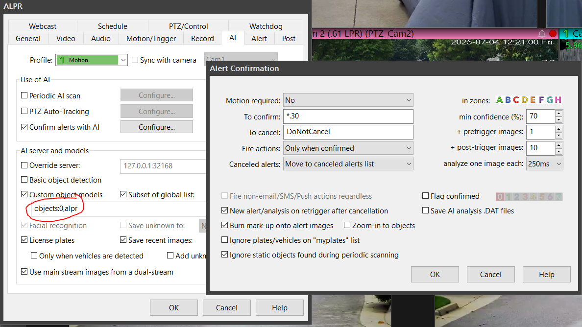

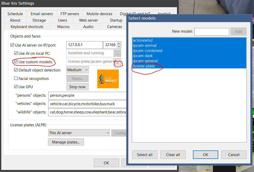

This might help.
Reactions: algertc
