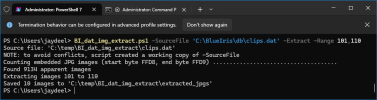

The screenshots below illustrate typical output...

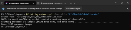

BI_dat_img_extract.ps1 -SourceFile 'C:\BlueIris\db\clips.dat'

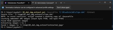

... counts the embedded JPG imagesBI_dat_img_extract.ps1 -SourceFile 'C:\BlueIris\db\clips.dat' -Extract

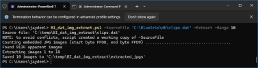

... first image onlyBI_dat_img_extract.ps1 -SourceFile 'C:\BlueIris\db\clips.dat' -Extract -Range 1,10
... first 10 imagesBI_dat_img_extract.ps1 -SourceFile 'C:\BlueIris\db\clips.dat' -Extract -Range 10

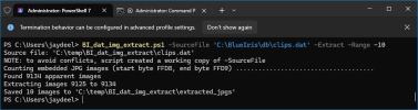

... dittoBI_dat_img_extract.ps1 -SourceFile 'C:\BlueIris\db\clips.dat' -Extract -Range -10
... last 10 imagesBI_dat_img_extract.ps1 -SourceFile 'C:\BlueIris\db\clips.dat' -Extract -Range 0
