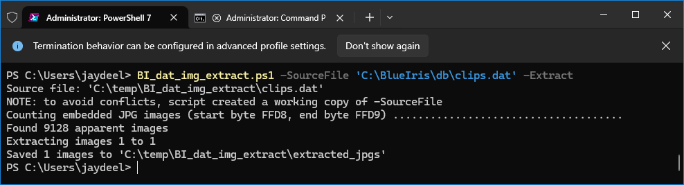

The screenshots below illustrate typical output...

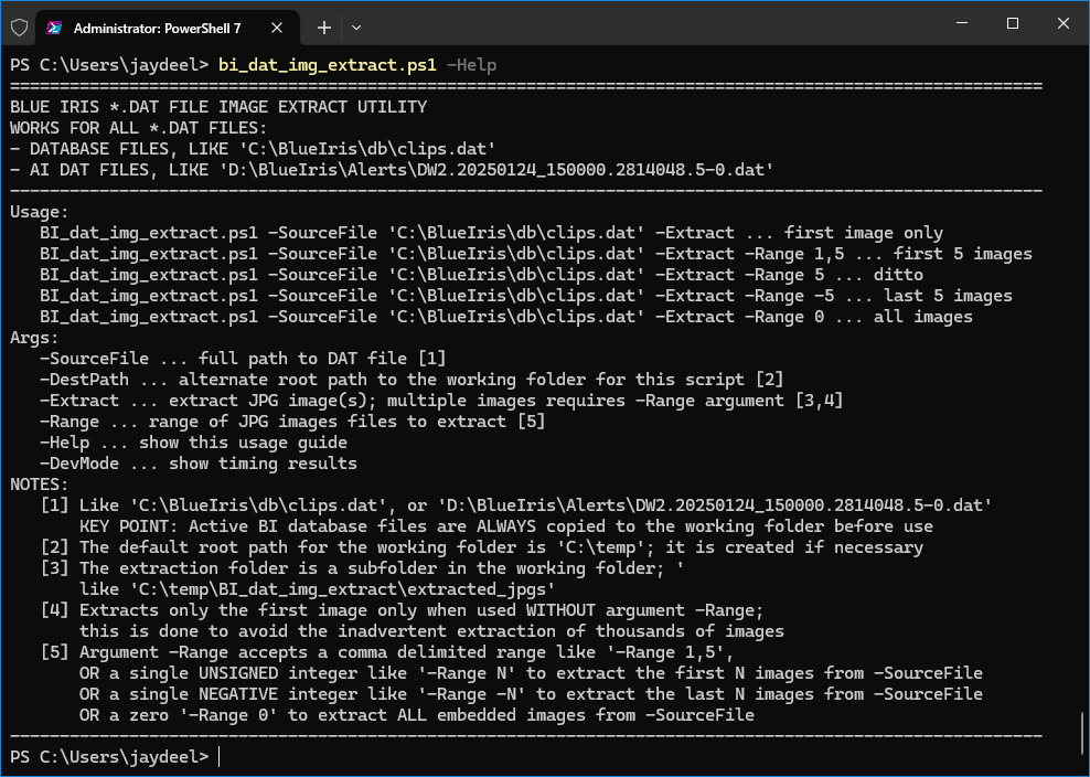

Here's a screenshot of the Help menu...

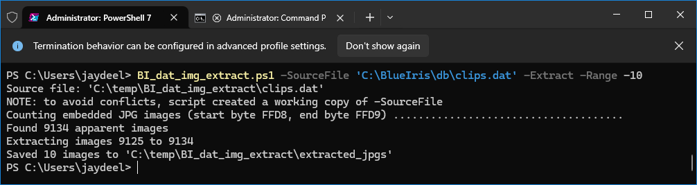

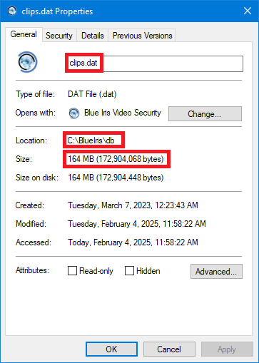

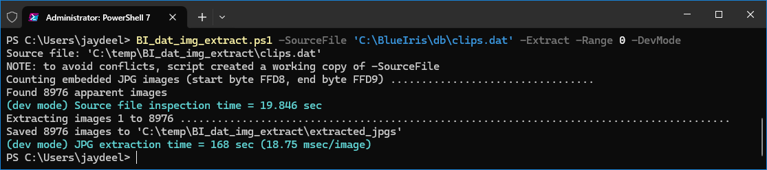

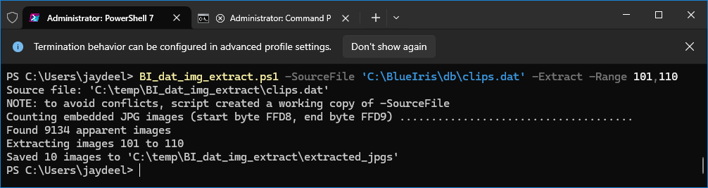

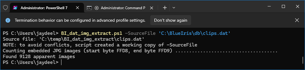

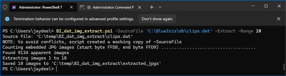

Here are some typical commands...

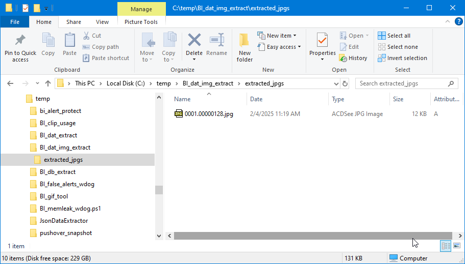

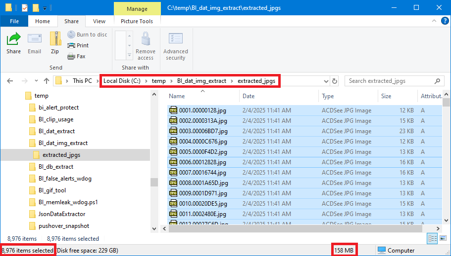

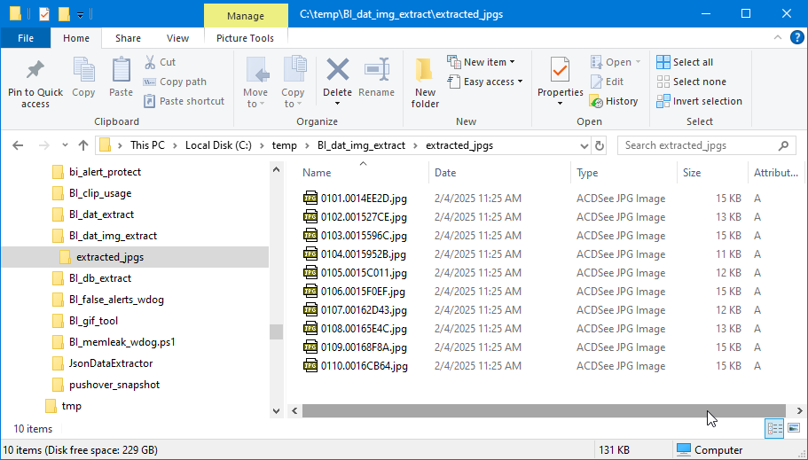

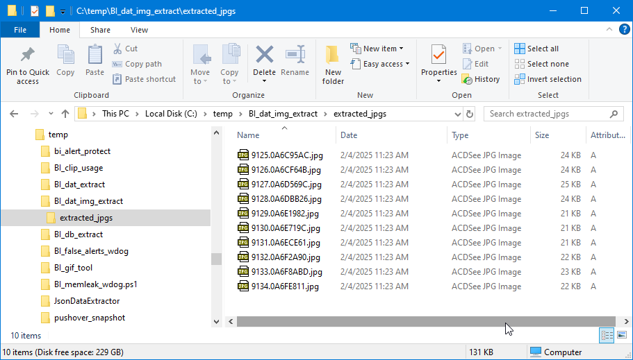

BI_dat_img_extract.ps1 -SourceFile 'C:\BlueIris\db\clips.dat' ... counts the embedded JPG imagesBI_dat_img_extract.ps1 -SourceFile 'C:\BlueIris\db\clips.dat' -Extract ... first image onlyBI_dat_img_extract.ps1 -SourceFile 'C:\BlueIris\db\clips.dat' -Extract -Range 1,10 ... first 10 imagesBI_dat_img_extract.ps1 -SourceFile 'C:\BlueIris\db\clips.dat' -Extract -Range 10 ... dittoBI_dat_img_extract.ps1 -SourceFile 'C:\BlueIris\db\clips.dat' -Extract -Range -10 ... last 10 imagesBI_dat_img_extract.ps1 -SourceFile 'C:\BlueIris\db\clips.dat' -Extract -Range 0 ... all imagesTo inspect AI DAT files, replace the
-SourceFile value to something like 'D:\BlueIris\Alerts\DW2.20250124_150000.2814048.5-0.dat'.By default, the JPG images are extracted to folder
C:\temp\BI_dat_img_extract\extracted_jpgs.The destination folder is user-configurable using the

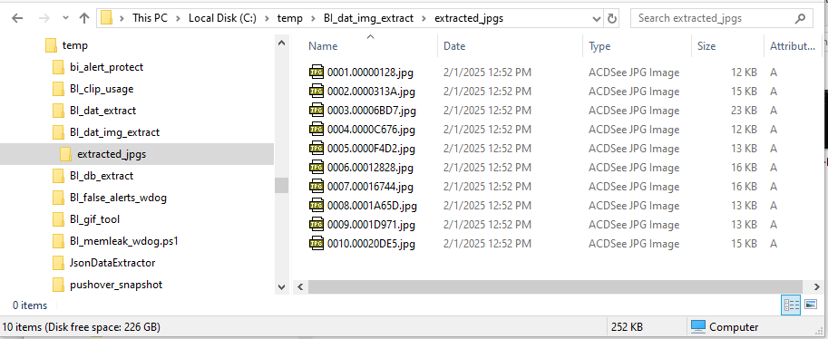

-DestPath argument.The JPG filenames are like
01.0000005F.jpg, where the first value is image number and the second value is the hexadecimal offset of the start of the JPG image in the binary file.The screenshots below illustrate typical output...
