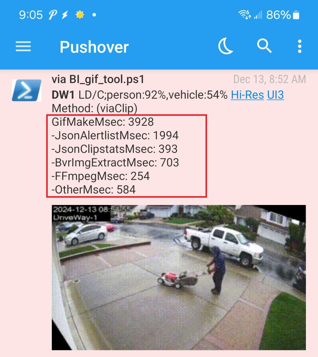

  • IMPROVED: argument -DevMode now includes detailed timing info, including: 1) timing info for JSON cmds, and 2) JSON alertlist response for argument -Latest
It may worth reiterating that this script no longer requires DAT files to create GIFs.
Why you might want to use this update:
  1. You want to use the script with older version of Blue Iris (tested back to 5.7.3)
  2. You want faster notifications

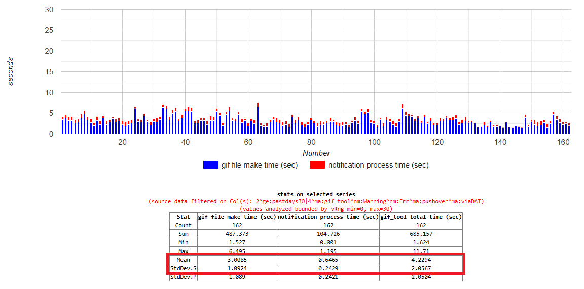

Performance results...
I'm routinely seeing GIF make times of ~3 sec for DAT files containing 10-13 JPG images.
This chart also shows Pushover notification process times.
Additionally, I'm seeing even faster GIF make times when extracting the JPGs from the BVR file (via argument -IgnoreDAT). Despite this, I still prefer to use DAT files because, unlike using BVR files, every frame in the GIF contains the object of interest. Using BVR files can require some 'tuning' to trim frames from the entire alert duration used to create the GIF.

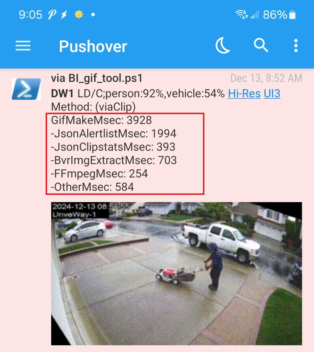

... but the GIF make times I am experiencing are all over the place so far. The ones created through .DAT files are relatively fast (roughly 3-4 seconds in a short set of tests), but when the script has to fallback onto using the "Clip" method (JPEGS extracted from the .BVR), the full creation times spike to 20-23 seconds! Is that directly related to the alert length (ie: the script cannot complete until the Alert clip has finished)?
Currently I'm testing 5 cameras using the following command in the 'Run a program' action Params field and all are consistently creating GIFs from BVR-extracted JPGs without any delay.
Code:
"C:\ps_scripts\BI_gif_tool.ps1" -Camera '&CAM' -Latest -IgnoreDat -AlertMemo '&MEMO' -Msg """<b>&CAM</b> &MEMO <a href='&WAN/alerts/&ALERT_DB?fulljpeg'>Hi-Res</a> <a href='&WAN/ui3.htm?rec=&ALERT_DB'>UI3</a>""" -Priority 1
Is the command you struggling with using both arguments -Latest -IgnoreDat ?
BTW, you can get an 'under-the-hood' peek of the script's timings by enabling two settings in the user-settings file: $append_performance_tag_flg and $append_performance_tag_details_flg. These will append additional info to the push message (highlighted in the red box in the screenshot below).
Doing this might provide some clues on what you are observing.
Reactions: jrbeddow

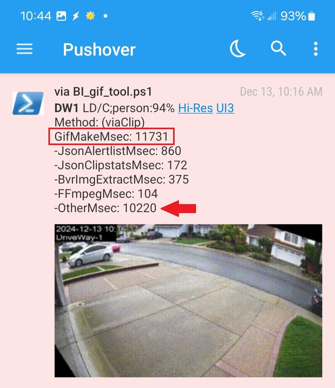

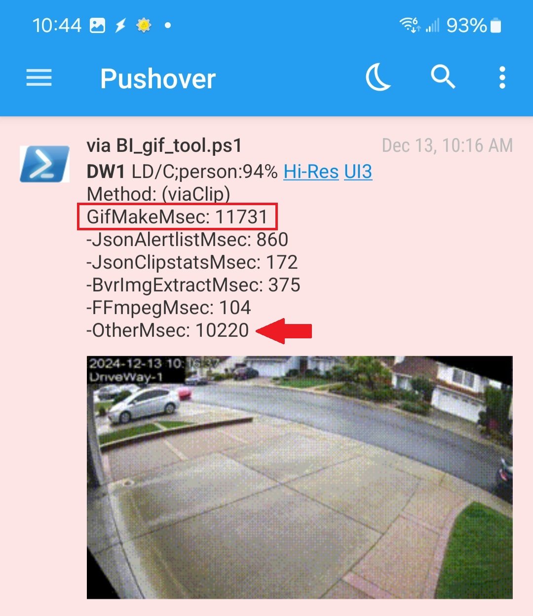

Seems I spoke too soon...
After my previous post, I started working on another project. Afterwards I decided to collect some more GIF notifications.
This time I saw reproducible delays.
Example:
I was able to restore the previous behavior by rebooting the server.
I'm reviewing the code to look for a better way to handle this situation, or at least minimize the delay.
BTW, I misspoke earlier when I agreed with your guess that the BVR extraction delay was determined by the alert's duration. It's currently 2 * (pre-trigger record time).
EDIT: You can experiment with user-specified delay durations via argument -BvrDelayMsec.
