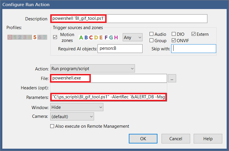

Key features of this new version are:
  • BREAKING CHANGE: must replace old user-settings-file
  • ADDED: script now supports temporary DAT files created in the Blue Iris 'Temp' folder (v5.9.9.29+) ... learn more here.
  • FIXED: bug in logic that retries getting the alert's JSON clipstats object
  • IMPROVED: argument -PushService and user-setting $push_service now support simultaneously using both notification services 'Pushover' and 'Telegram'
  • CHANGED: Pushover API now accepts attachment sizes up to 5.0MB (previously 2.5 MB)
  • CHANGED: added a short wait, if needed, for Blue Iris to finish writing an alert's DAT file
  • CHANGED: default notification title now includes the script version
Why you might want to use this update:
  • You never liked the idea of creating a DAT file for every Alert just to use this script.
  • You like the idea of simultaneously sending critical notifications via two push services.
Under the hood:

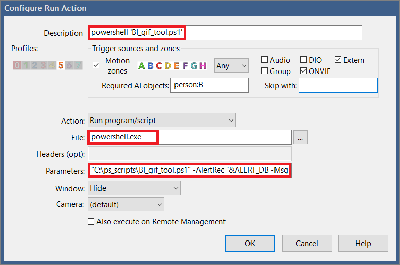

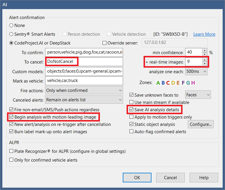

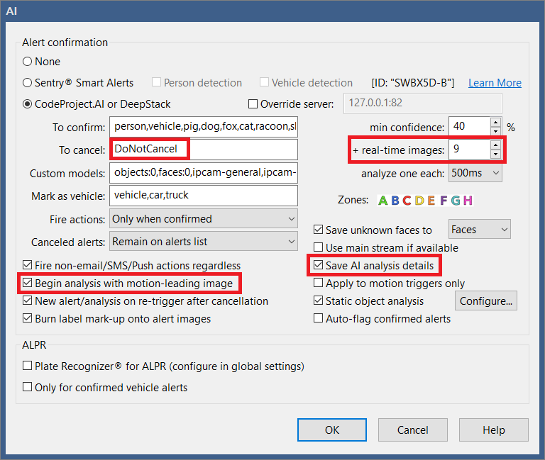

As of v5.9.9.29, Blue Iris automatically saves temporary DAT files when using the following settings in the Camera settings > Alert tab:​
  1. 'Confirm the alert with AI' is enabled.
  2. 'AI configuration' > 'Save AI analysis DAT files' is NOT enabled.
The new temporary DAT files are created in the Blue Iris 'Temp' folder ... typically C:\ProgramData\Blue Iris\temp.​
KEY POINT: these files are ephermeral - they will last only until they are overwritten by the next Alert.​
Examples:​
This folder is user-configurable via Settings > Other tab.​

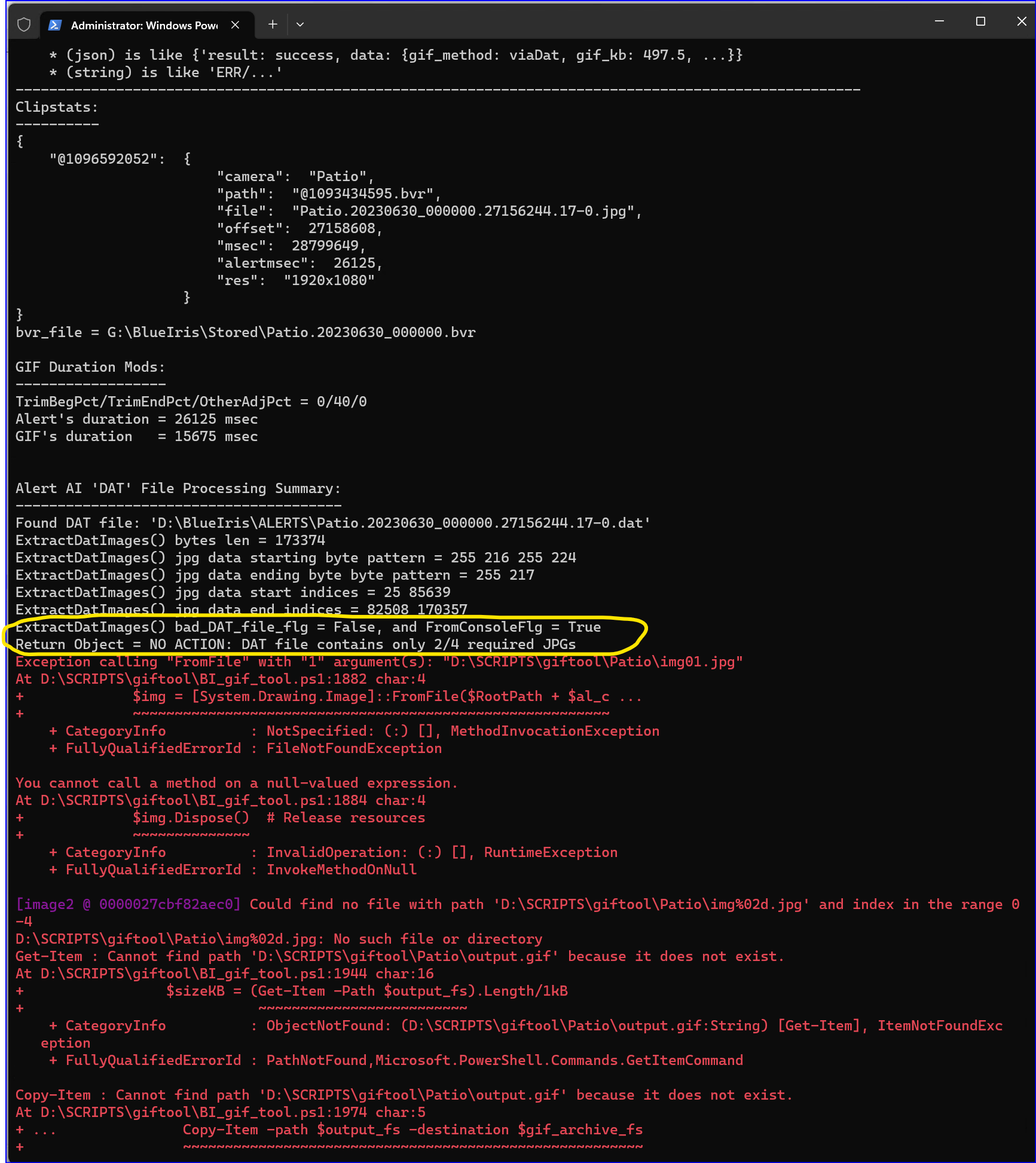

Trying this out and got everything setup how I think is right, but when testing I get this error:
ERR/unexpected response from MakeGIF(): 'ERR/unexpected number of images extracted from BVR (found 0, expecting 10)'
Please share the Bue Iris version, script version, and command line syntax you are using.
Please confirm that the DAT is good by double-clicking on it from Windows file explorer. This should open the file in the Blue Iris DAT viewer.
Also try adding the -DevMode argument. Share the DAT file and script output via DM.
EDIT: Oops, I misread that the script is actually trying to extract the JPGs from a BVR. This is a non-ideal fallback when it cannot find a DAT file. Just DM the script output w/ -DevMode.
