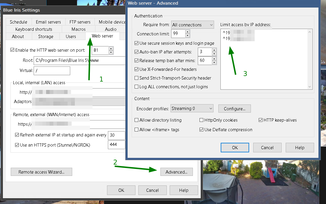

first of all, Thank You! amazing work.

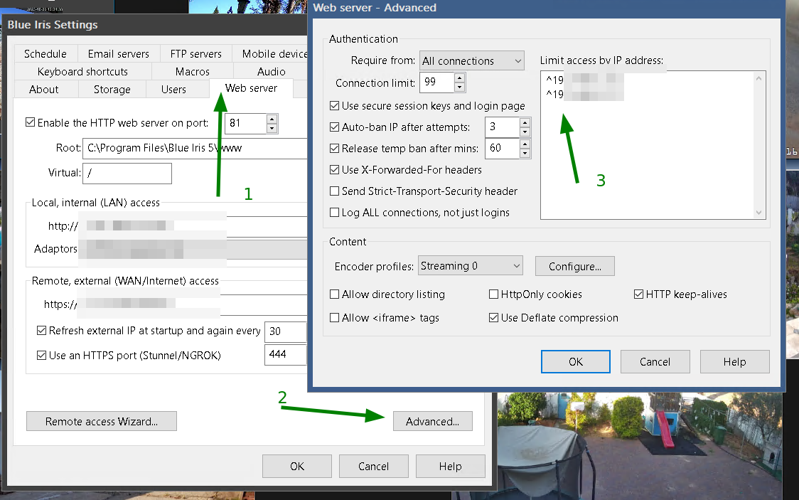

in order to make it work with jpeg from bvr, I needed to add the ip of the machine running the script to the setting -> web server -> advanced
with ^ prefix so no password is required (at least on my computer it didn't work until added)
example:
^192.168.1.50

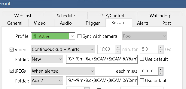

But my issue is with DAT extract, my export location for bvr & alerts is with some sub folders to make it easier for windows to browse...
the extract works but the create gif command is searching in another folder (without the sub folders) for the jpgs...
my Video "special" path is : (D:\Blueiris\New) + %Y-%m-%d\&CAM\&CAM.%Y%m%d_%H%M%S (example: "D:\BlueIris\New\2023-10-20\Front\Front.20231020_160000.bvr")
my Alerts "special" path is : (D:\Blueiris\Alert) + %Y-%m-%d\&CAM\&CAM.%Y%m%d_%H%M%S (example: "D:\BlueIris\Alerts\2023-10-20\Front\Front.20231020_142356.289015.3-1.dat")

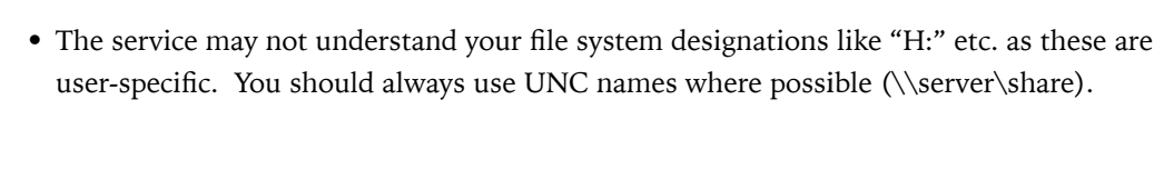

Appreciate your reply jaydeel. Yes, confirmed that the pathing is correct for $bi_alert_folder_path.
EDIT: Actually, now that you mention it, I tried using the UNC path (/server/bi/alerts) instead of the locally mapped path (D:/bi/alerts) and it seems to be working. Thanks!!!
Good catch. This is mentioned in the Help PDF in the 'Testing the Action Set' section of the 'Alerts and Actions' chapter.

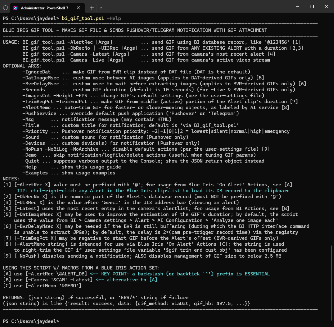

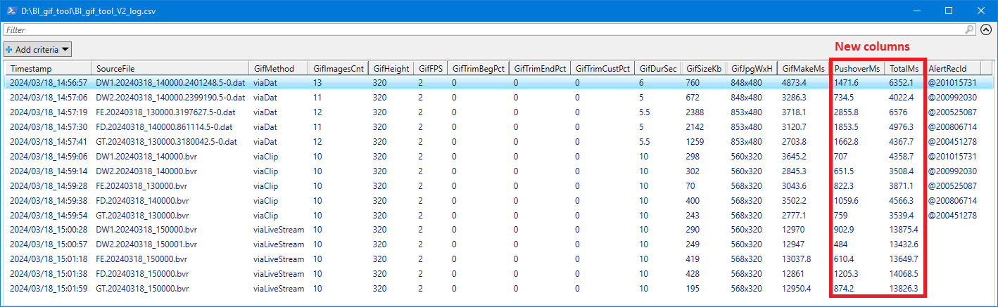

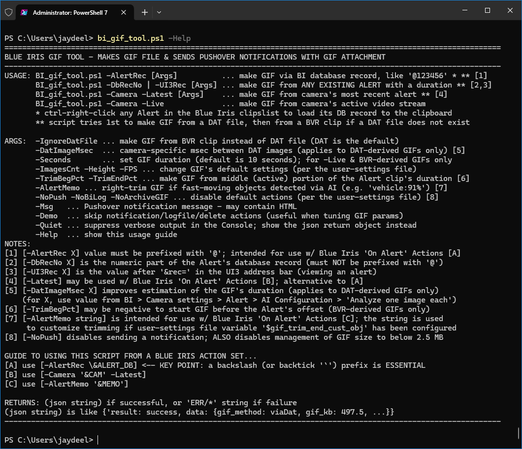

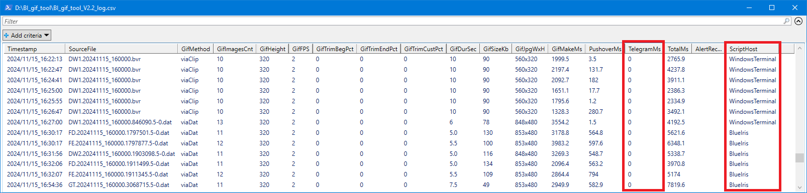

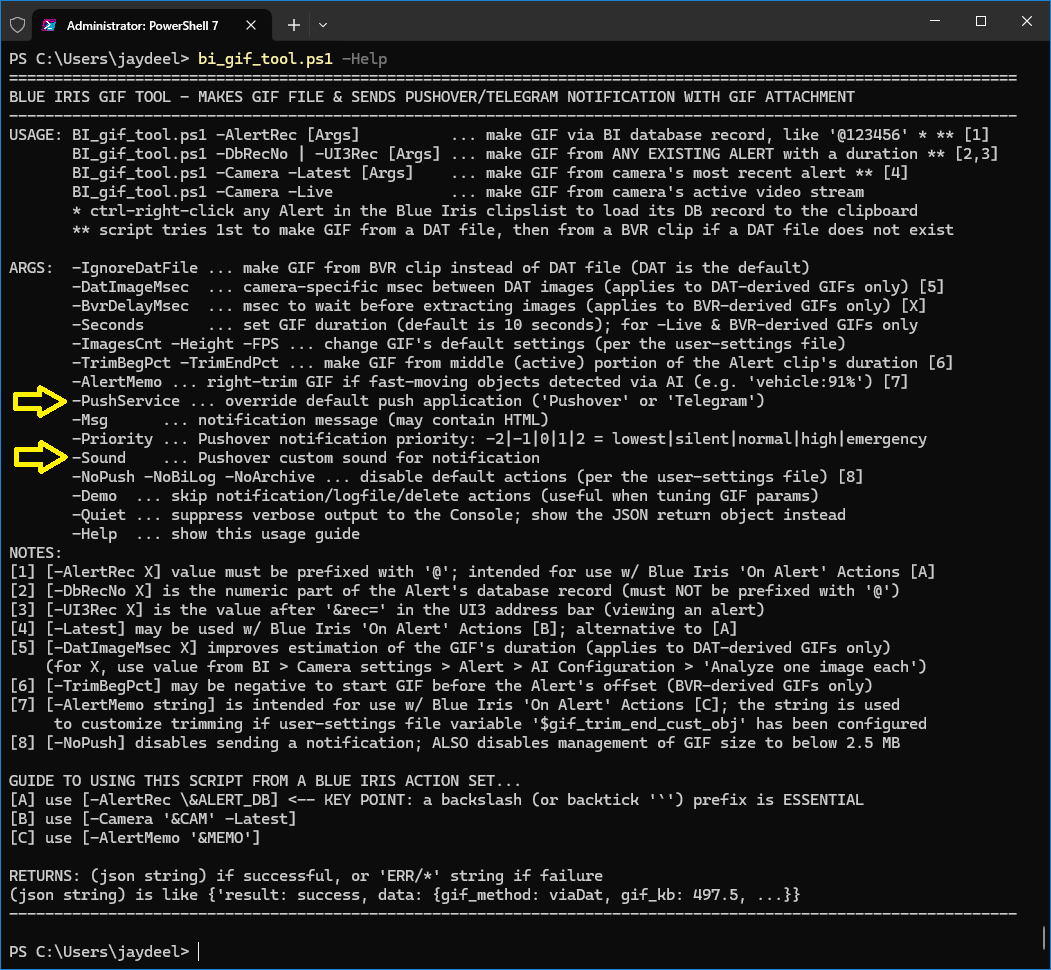

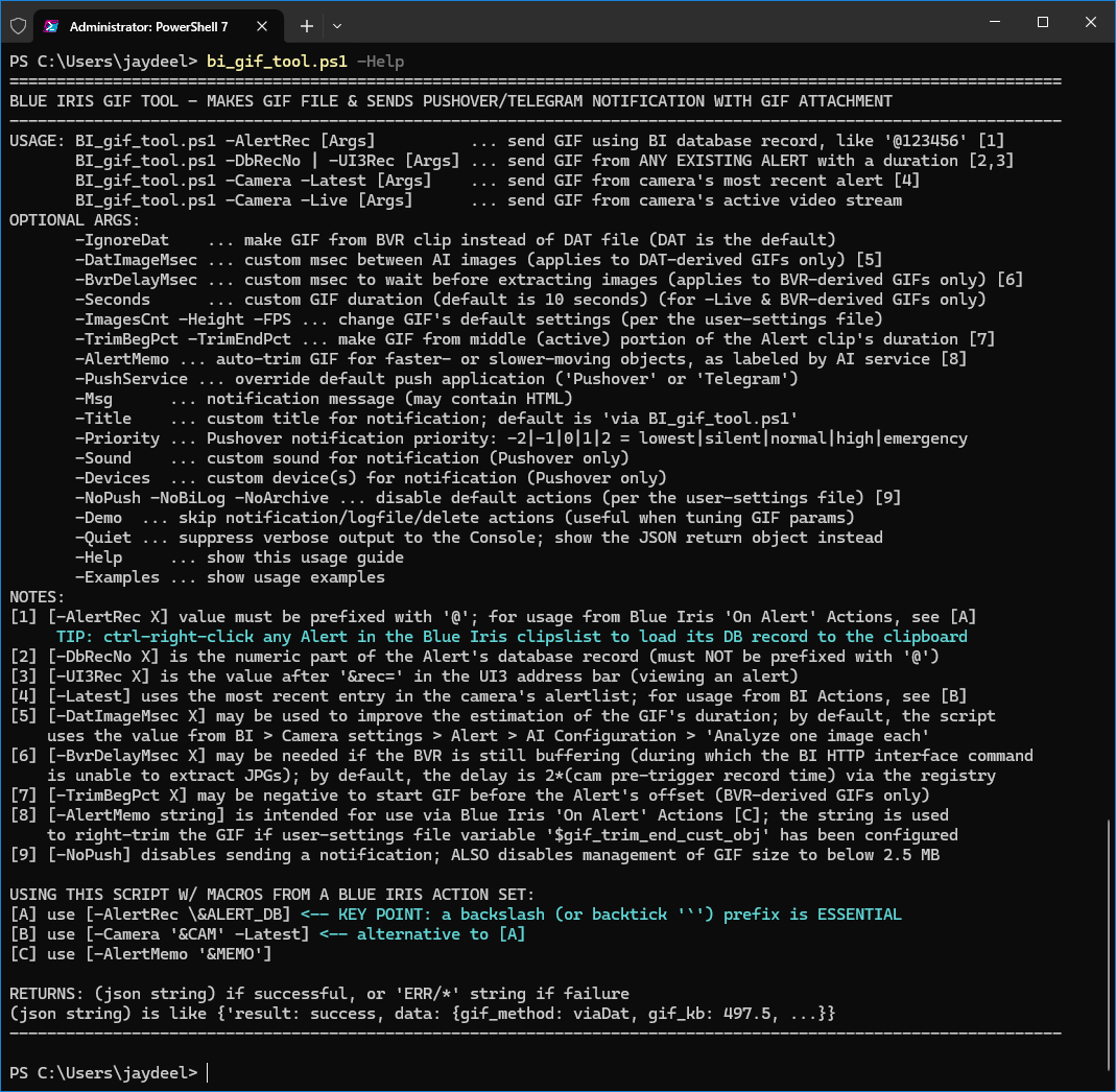

Script updated to V2. see post #1 to download the file
Key features of this new version are:

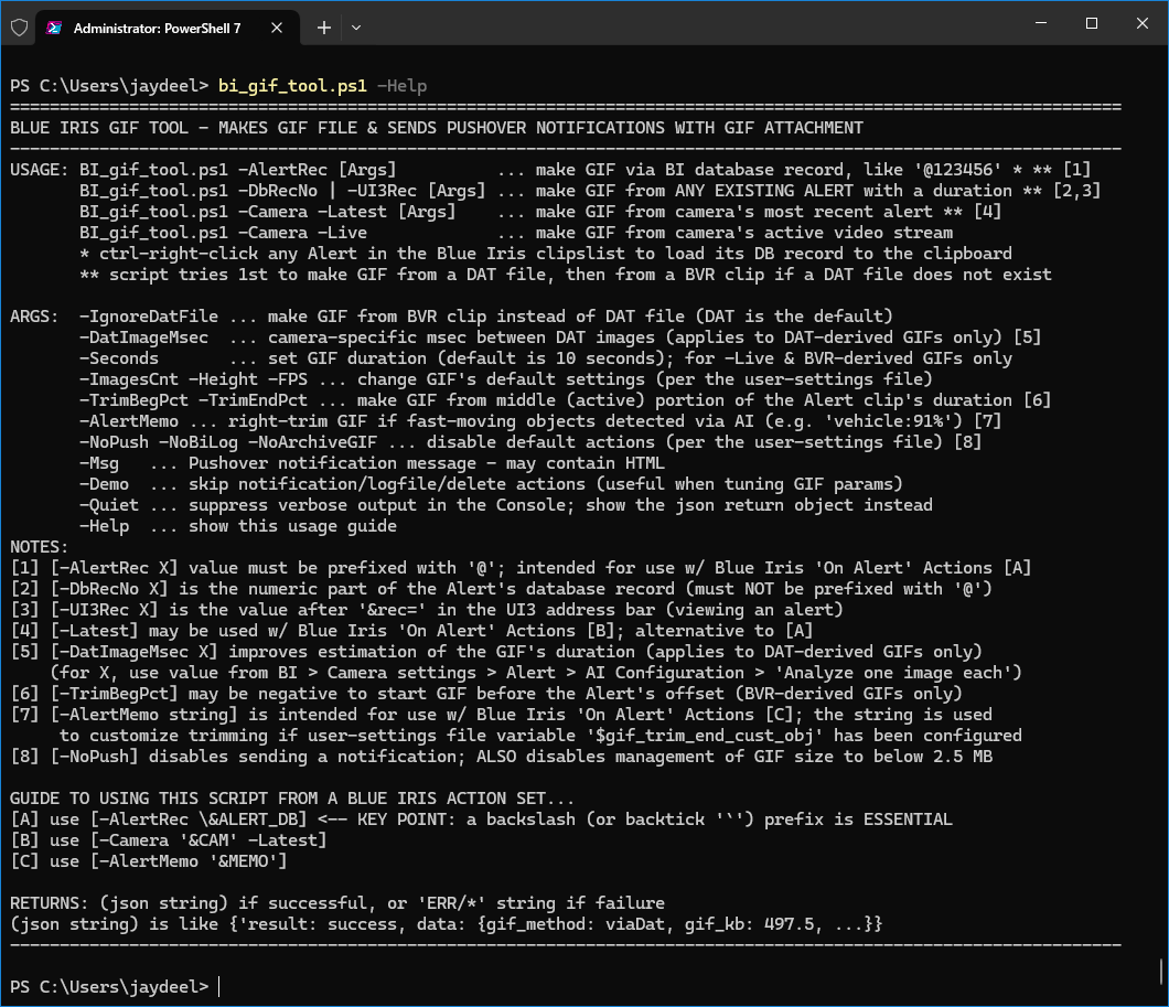

  • An improved usage guide (-Help argument, see screenshot #1).
  • Added argument -Latest to make GIF from a camera's most recent alert.
  • Eliminated the delay when using the -Live argument
  • Improved support for BVR-derived GIFs (for users that don't wish to create DAT files)
    • script now supports multiple Blue Iris 'New' folders

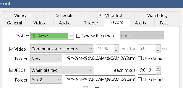

    • script now supports the use of non-default folder naming patterns in Camera settings > Record > Video (ADDED: 3/21/2024)
    • argument -TrimBegPct may be negative to include pre-trigger images in the GIF
  • Improved support for DAT-derived GIFs
    • added argument -DatImageMsec to improve GIF duration estimates
    • arguments -TrimBegPct & -TrimEndPct now ALSO work for these GIFs (by skipping the the extraction of an appropriate number of JPGs from the DAT file)

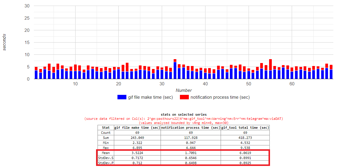

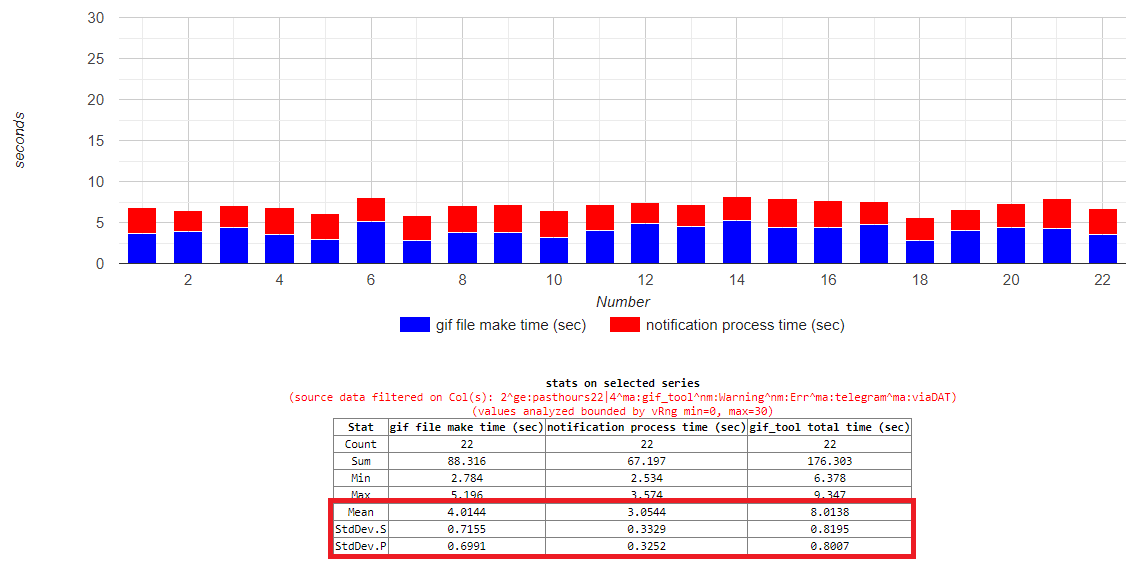

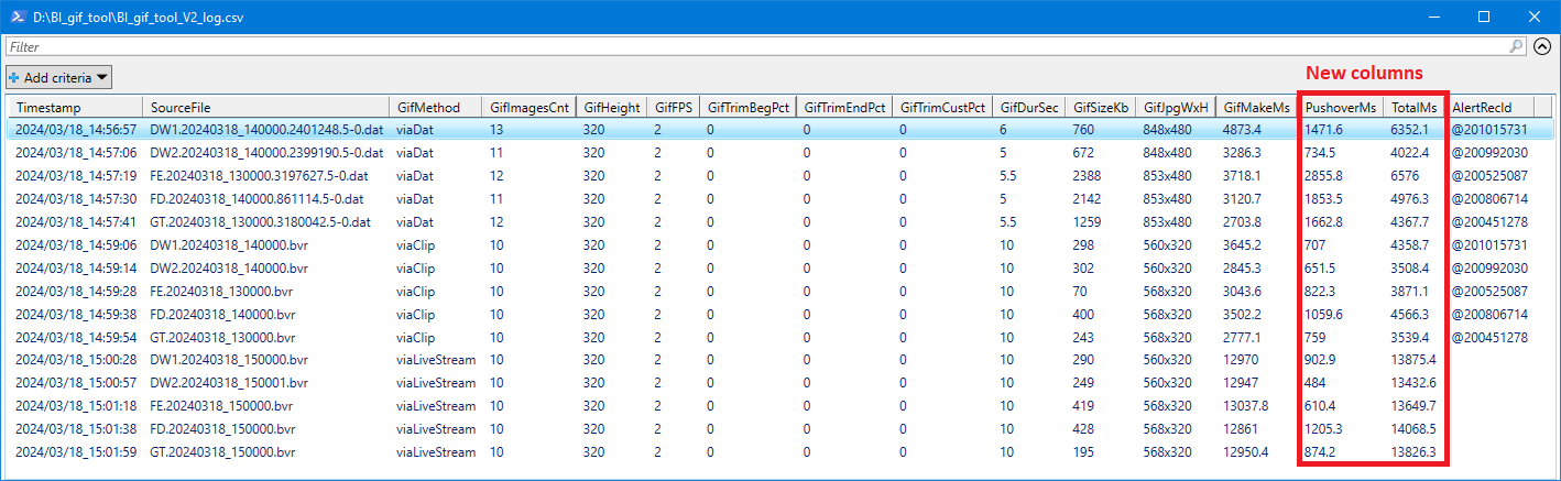

  • Added 2 columns ('PushoverMs' & 'TotalMs
    ') to the script's performance log (see screenshot #2)
Screenshot #1 - shows improved usage guide
Screenshot #2 - shows the new columns in the the script's performance csv file

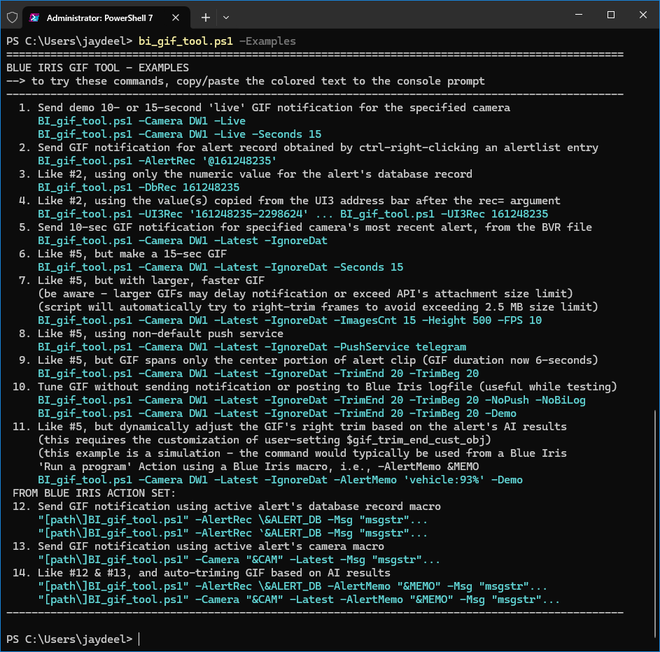

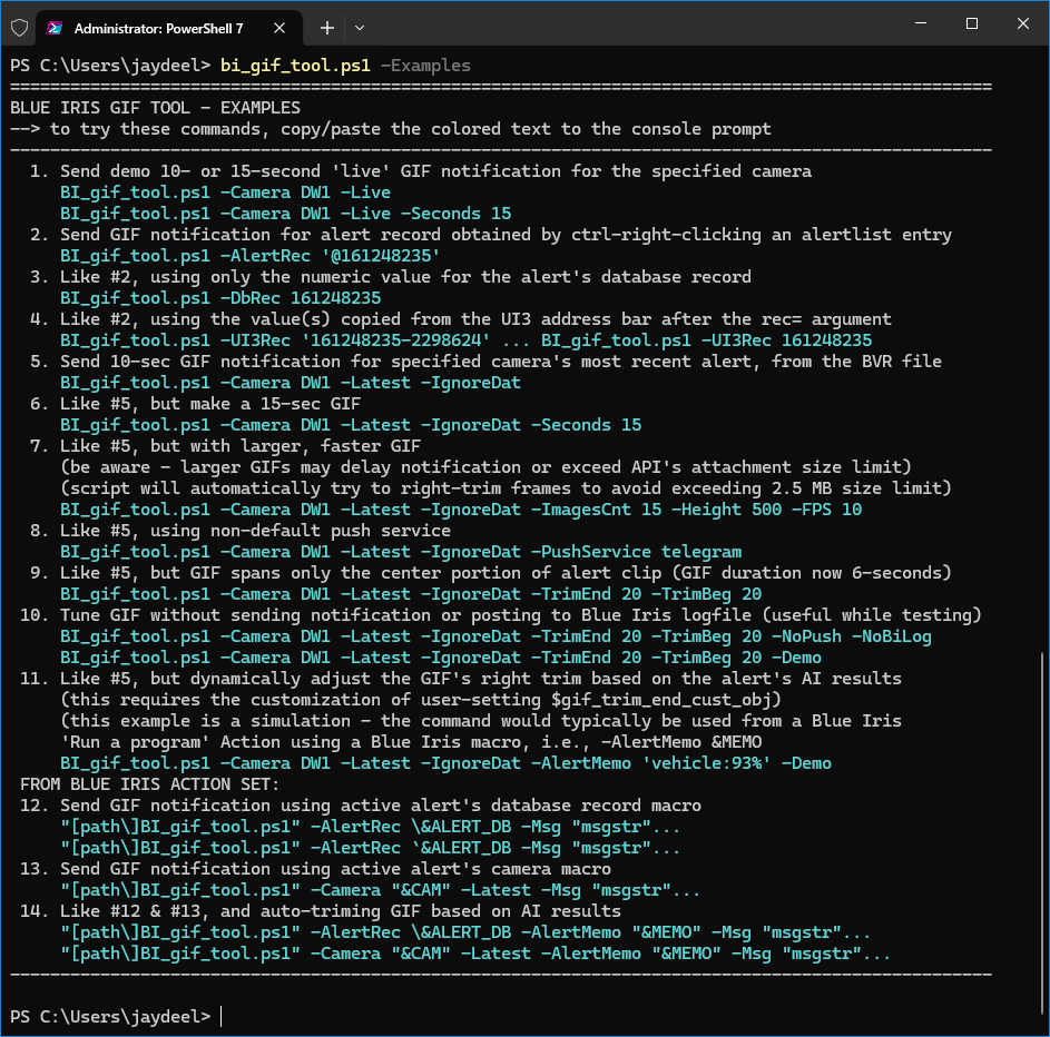

V2 usage examples...
Make and send a 'Live' GIF from a camera
bi_gif_tool.ps1 -Camera "DW1" -Live -Seconds 5
Note: the default duration without the -Seconds argument is 10 seconds
Make and send a GIF from a DAT file (if it exists), or a BVR file (if the DAT file does not exist)
bi_gif_tool.ps1 -Camera "DW1" -Latest
Force a GIF to be derived from the BVR clip
bi_gif_tool.ps1 -Camera "DW1" -Latest -IgnoreDatFile
Add pre-trigger images to a BVR-derived GIF
bi_gif_tool.ps1 -Camera "DW1" -Latest -IgnoreDatFile -TrimBegPct -50
How this works... the script extracts images from the BVR file before the alert's offset. the number of images is calculated as a percentage of the duration of the GIF (10 seconds, by default).

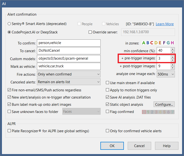

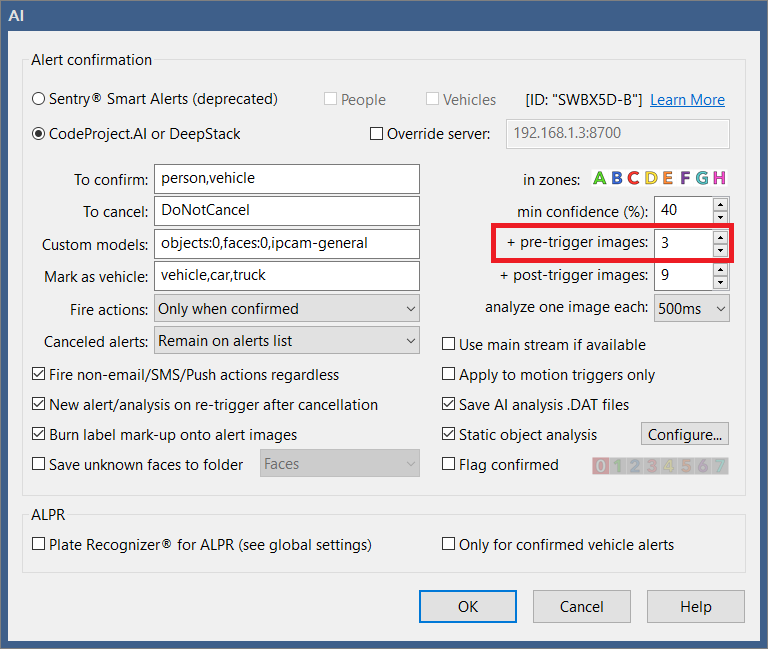

Add pre-trigger images to a DAT-derived GIF
Edit the camera's settings... Camera settings > Alerts > AI configuration > '+ pre-tre-trigger images'
Trim 2 images from both ends of a DAT-derived GIF, where the DAT file contains 10 images
bi_gif_tool.ps1 -Camera "DW1" -Latest -TrimBegPct 20 -TrimEndPct 20
The resulting GIF should contain 6 images

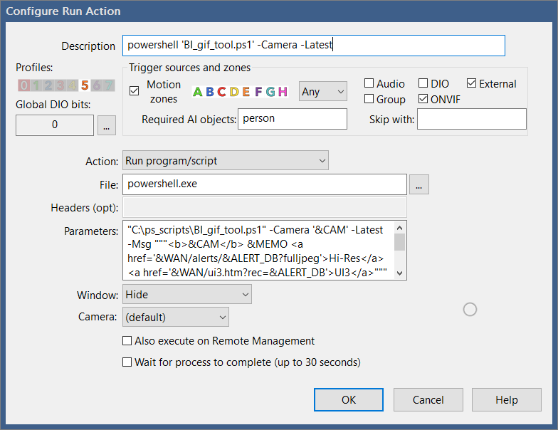

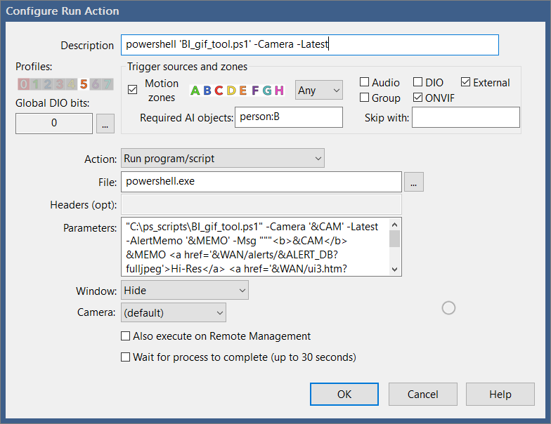

V2 Blue Iris Alert Action Set examples
This is the 'Run a program' Action 'Parameters' string that I'm currently using for most of my cameras...
Code:
"C:\ps_scripts\BI_gif_tool.ps1" -Camera '&CAM' -Latest -Msg """<b>&CAM</b> &MEMO <a href='&WAN/alerts/&ALERT_DB?fulljpeg'>Hi-Res</a> <a href='&WAN/ui3.htm?rec=&ALERT_DB'>UI3</a>""" -Priority 2 -FPS 2 -Height 320
This is the 'Run a program' Action 'Parameters' string that I'm currently using for my driveway cameras... It adds the -AlertMemo argument for custom trimming based on AI labels.
Code:
"C:\ps_scripts\BI_gif_tool.ps1" -Camera '&CAM' -Latest -AlertMemo '&MEMO' -Msg """<b>&CAM</b> &MEMO <a href='&WAN/alerts/&ALERT_DB?fulljpeg'>Hi-Res</a> <a href='&WAN/ui3.htm?rec=&ALERT_DB'>UI3</a>""" -Priority 2 -FPS 2 -Height 320
For example:
