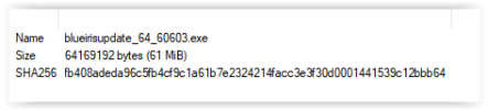

The recent updates that are posted for download appear to be incorrect versions, e.g. the 6.0.6.5 installs 6.0.6.3. (Updating from within Blue Iris installs the correct update.) Might be useful to add a hash calculator to the scraper that acquires the updates files, and if there's an identical hash with a prior version, flag it for correction before posting.
If the Bot is grabbing the updates from the main BI downloads updates page then I've complained on the other BI forum that the download is not always correct but little to nothing seems have been done and the issue still persists.
yes, but adding a hash calculator to the ipcamtalk scraper that acquires the updates files, that test if there's an identical hash with a prior version, and flag it for correction before posting, would then provide a means for ipcamtalk to not post a known incorrect version that users would download.
