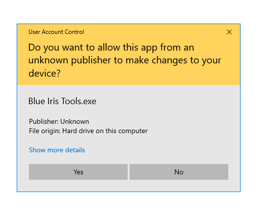

Did I miss where it was discussed how to avoid this popping up? If my computer restarts for whatever reason this prevents BI tools from starting which prevents BI from starting. Thanks
I'll take a shot at this - there was previous discussion in this thread about 'RunAsService' - during setup you need to specify an Admin account. Thats one way. Another way is to use Task Schedule and set an Admin account - that too should bypass the security check. Finally,
This basically creates a scheduled task, which allows you to modify elevation - then create a batch file that points at that and allows a manual execution. The author on this page uses this to get by numerous admin applications popping off warnings. I myself did try a number of tests on the EXE and couldn't get it to run without using the trick to create a manual scheduled task with a shortcut. Given this runs on my server, and I automate a lot for reboots, I stuck this in my scheduled Tasks a long time ago.

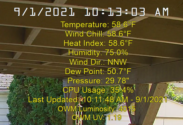

My experience with WU was picking a solid station was important. Regardless, I also 'import' data from OpenWeatherMap service to supplement needed data. Here you can see the last 2 values are from OWM :
I need the Luminosity as it defines the on/off for lights in my smart home. I display it here so I can monitor it in Hubitat, my smart home central device. Consider that you could extend what I've done here to gather values for any/all weather monitors/sensors from any source.

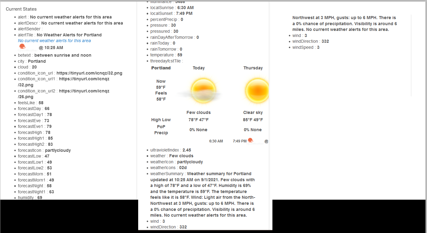

Here's a screen cap of SOME of the variables it produces:
Basically - I pull the values I need with a script on a 30 minute schedule and store it into a text file. then I have BITS overlay that text file. Hope this helps someone!

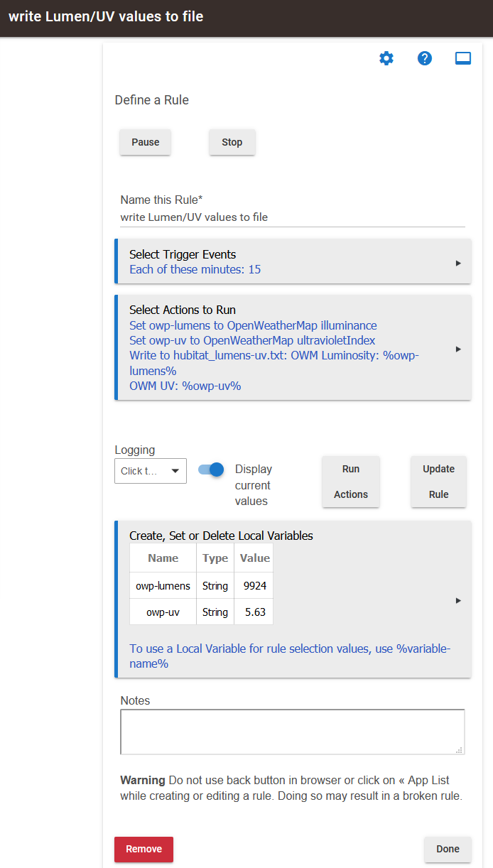

Love to share - and nothing so complicated - Since the driver exists in Hubitat as a Device - it's simple to look at the current device and see all the value key pairs - thats were I created the screen cap above in white.
Then, using a Rule written in Hubitat I push the values I want into a text file. First I setup 2 local variables, and then the rule runs every 15 mins, writing the OWM values from the device into the variables. Then I 'write' the varialbes to a txt file that is exposed to BlueIris. At that point BITS takes over on a schedule and writes those values into the overlay. Writing this description took longer than doing it! Here is the Hubitat rule:
