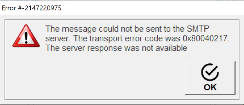

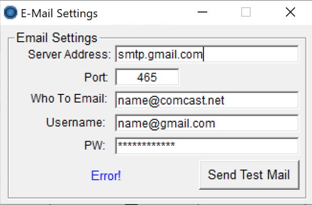

I just did a clean install of Windows 10 and BI5. I installed BI Tools and I can't get email to work. I'm using a Gmail account to send from but no luck. Any thoughts? Thanks

Says I can't access that setting using my standard Google account, must be a G Suite account. I have no idea.
I have free gmail, not gsuite. I got your error, then i flipped to allow less secure and it worked
try searching for enable less secure apps gmail
or if you are actuall connected with comcast, use that email
Reactions: 105437
Comcast worked. Thanks
