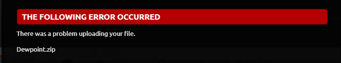

I was finally able to put together an BIT addon to calculate dewpoint. I have it ready to share but I can't upload the zip file. I get an error every time I try. Thoughts? Also, what is my IPCT member #? I don't see that anywhere in my profile.

Awesome! What is the error when uploading the zip? Are you uploading to the Downloads section? You member # is 41199.
Thanks for the quick response. Error screenshot attached.
