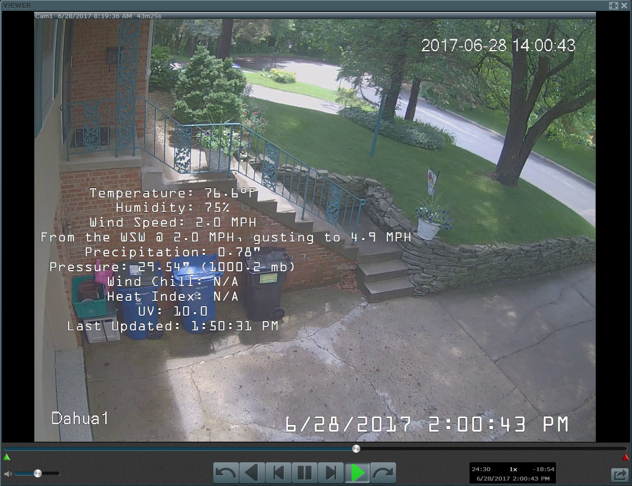

I'm a newby and have searched the forums but am not finding an answer, so I apologize in advance if I need to be pointed in the correct direction. I set up BIT and the weather overlay looks great on my camera! My question is yesterday it was raining off and on all day and I was expecting to see an accumulation of precipitation but BIT kept displaying different varying amounts through the day, then at the end of the day it displayed 0. Is there something I can do to change the BIT display to read the daily total throughout the day? WU displays a total of .35 for the day. Thanks so much!!!
@Debbie I believe WU is reporting the hourly rainfall, not the total from midnight.

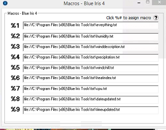

I'm having a hard time getting the weather overlay to work. I'm on BI 4.5.9.2, BIT 1.1.4. I've followed all of the instructions to set up the wx overlay in BIT and have populated all of the macros. In BI, I type in %1, and nothing appears.
Seems I had the same Issue a few days back and Once I went into Blue Iris tools options and hit the Detect version button at the top center, it repopulated the directories properly and made magic happen..
You might give that try.
That did work, although I had to tick BI3 then detect, and then it started showing up.
