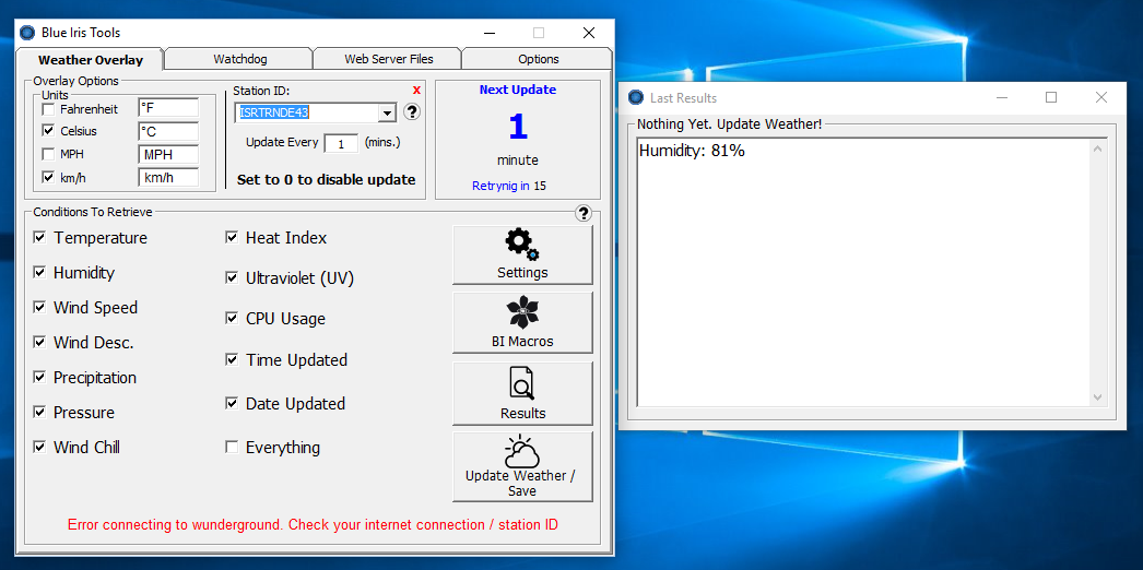

Running BI 4.2.9.0 and BI tools. Cant get the weather ovelay to work. Error connecting to wunderground... Nothing wrong with my connection! BIT generates only 2 txt files.. cpu and humidity.. Any solutions? BIT.PNG

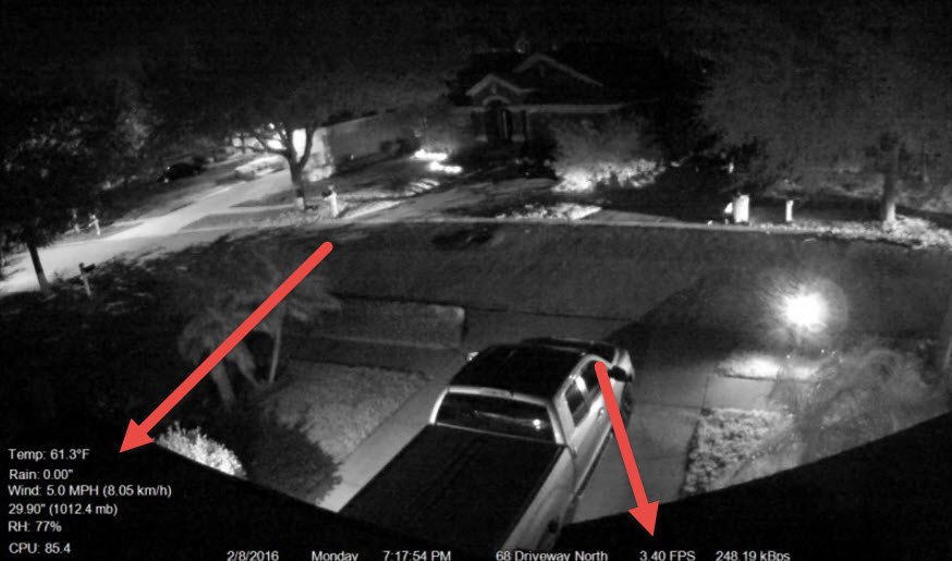

So, having had a few more days to play with this, I've noticed a peculiar side-effect. So far, I've only applied the macros to one (of my 30) cameras. Initially, I had only CPU and temp (as a single line), and it was working just fine.
All of my cameras are the 3MP Hiks - set to 720, 15fps. I also have date/time/camera name/FPS/KBps as an overlay, all on a single line.
I then tried adding multiple lines, each with its own BIT variable (wind, temp, humidity, pressure, cpu). After doing so, the frame rate on that particular camera becomes very volatile - dropped to about 4FPS. As soon as I removed the lines, it went back to 15fps. What's even more interesting is that all the other cameras remain at 15fps, while the one with the extra lines of overlay text is at the lower rate.
This is the long way of me asking, does the number of BIT variables/lines used in an overlay have that much of an effect on BI's ability to maintain the camera's frame rate?

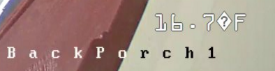

Hi, I'm running version 1.1.0 with blue iris 4.2.9.1 x64 and I recently ran into an overlay issue where the degree symbol (for temperature) shows up as an unknown character with the OCR A overlay font. Is this a blue iris issue?
I have this running on two different BI servers. Both began showing the same funny characters at the same time. My guess is, unless BIT updates itself, BI server updates probably don't know what to do with the degree (°) symbol..

Also having the degree symbol problem.
I think this is more of a Blue Iris problem. I went in and modified the temperature.txt and pasted the degree symbol from windows character map and got the same result. In fact any special symbol that is tried yields the same result. But if you put the degree symbol directly in the macro field in BI it works. Maybe something with reading from the text file. There was a BI update a few days ago....
Version 4.2.9.2 just released and the Symbol issue is fixed.
