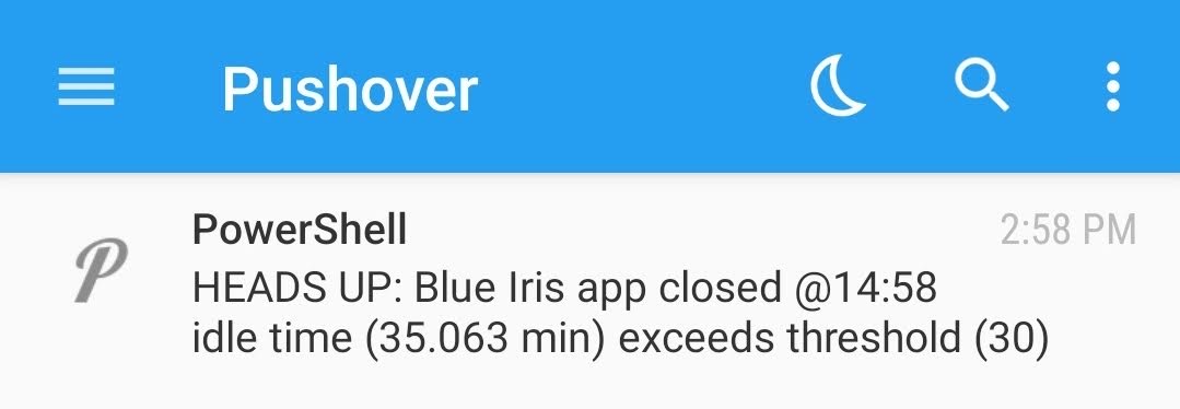

1. [Optional] Editing a PowerShell script to configure your custom idle time. And Pushover settings if you want to receive notifications, like this

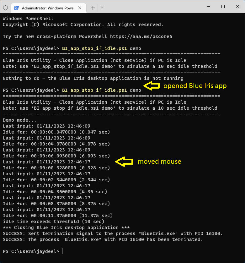

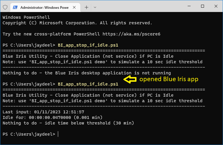

The following screenshots illustrate the script's output (in a PowerShell window).
1. Usage in 'demo' mode.
2. Usage in normal mode.
