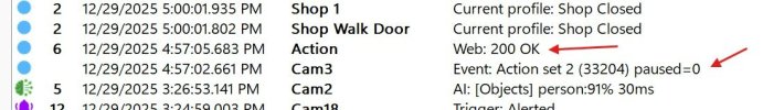

@bp20089 has instructions for something like this in his post where he said he has stopped using his sunrise/sunset app.
Yes, but that was before Ken added "Action sets" Now you no longer need to mess with PTZ presets on each camera, one camera can change all the cams day/night profiles with a lot less clutter.
