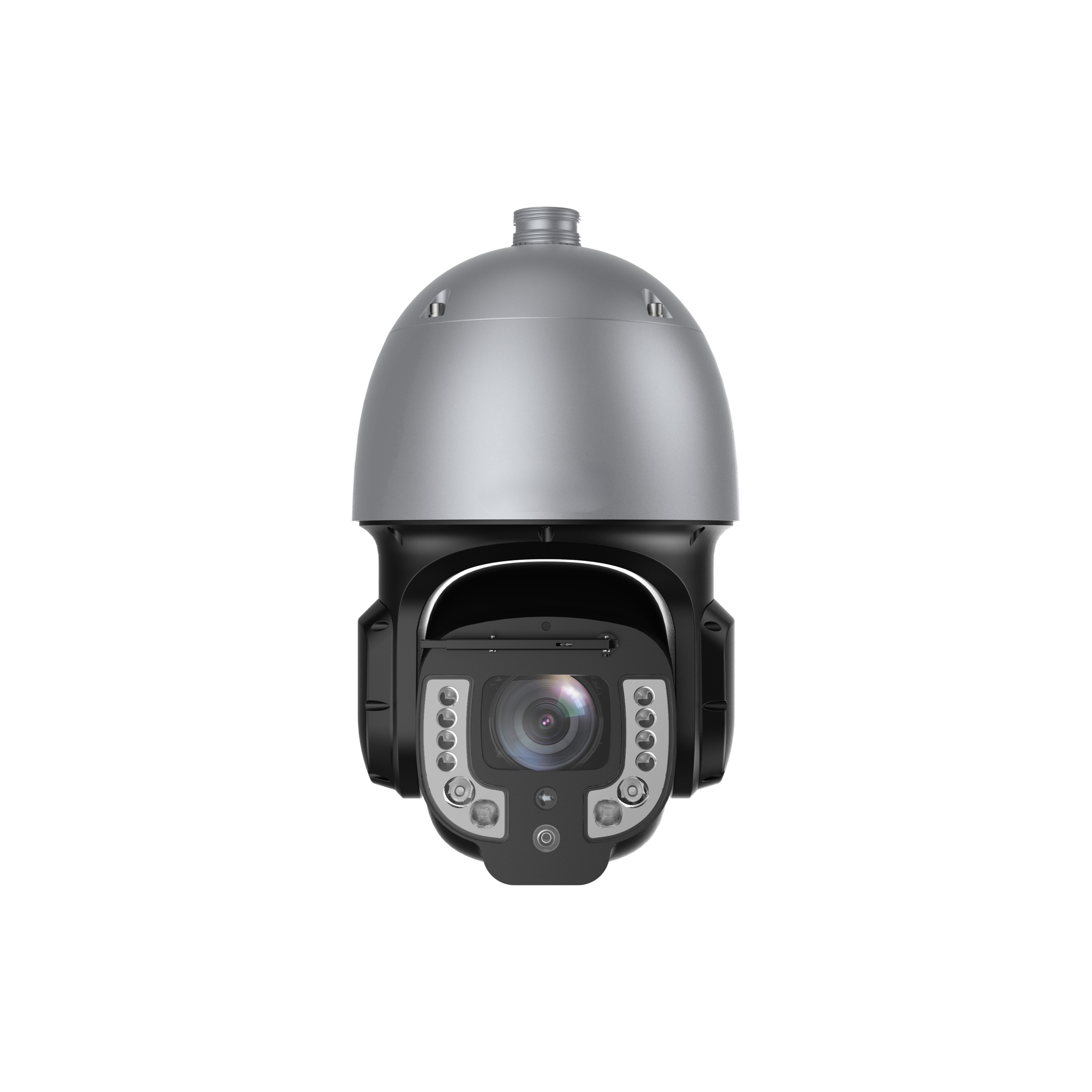

@EMPIRETECANDY Any update on the big PTZ?
Have one of the latest laser PTZ out, a big monster.
Reactions: amdpowered
That is interesting. I thought there was a 1/1.2” sensor one as well?
I would say that is industrial size.
Just to be clear. There was a 1/1.2" PTZ mentioned previously at the beginning of this thread. That has been discontinued before it was released?
No before have one, but the new one have some problem on lens, still need to find a good lens to work with the 48X 1/1.2CMOS 4K. Have to wait to 2026 i think.
