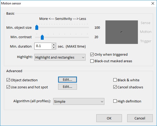

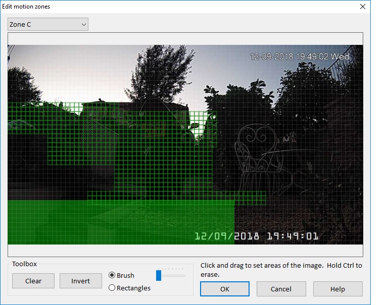

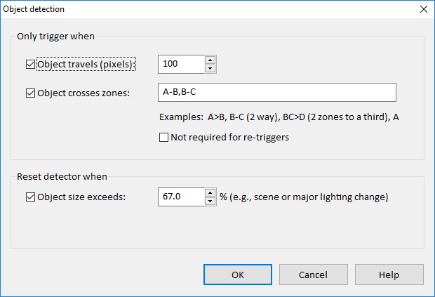

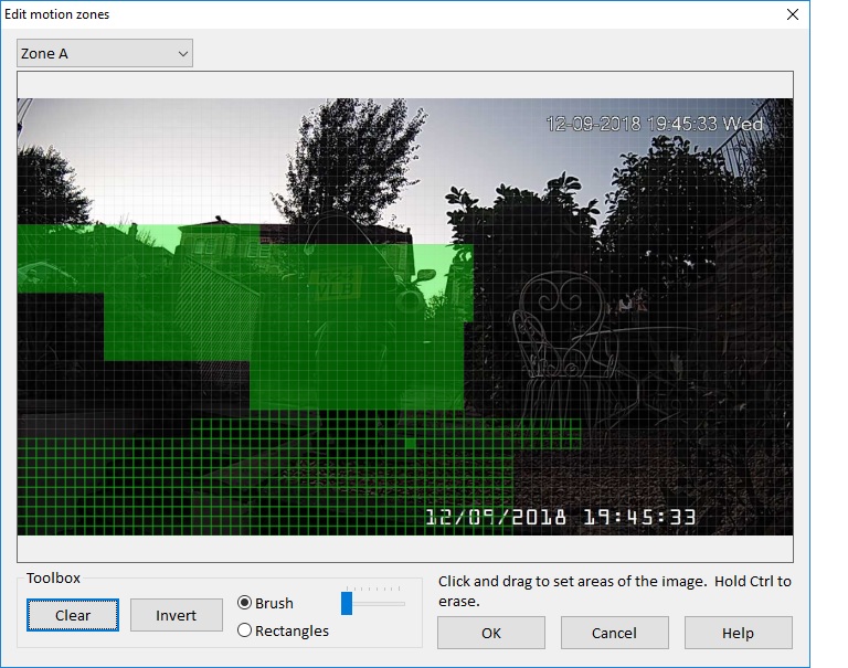

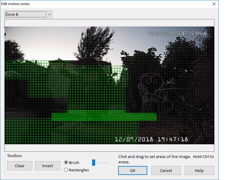

So I have been trying to set up zone crossing but for some reason they just aren't working.
I've pasted screenshots below showing that the zones and also that they lap over each other, some guides say do this, some guides say don't overlap but I've tried both ways still without any luck.
I very rarely get it working, if it does it's from zone B - C or vice versa but I haven't ever seen A-B either way working.
Can someone please explain what I'm doing wrong
I've parsed a test video through it but no detection
I'd love to know what I've missed as I've followed several guides and can't see what the problem is

Try eliminating zone B. Leave A the way it is but combine B & C into just B. Maybe your current B is too narrow.

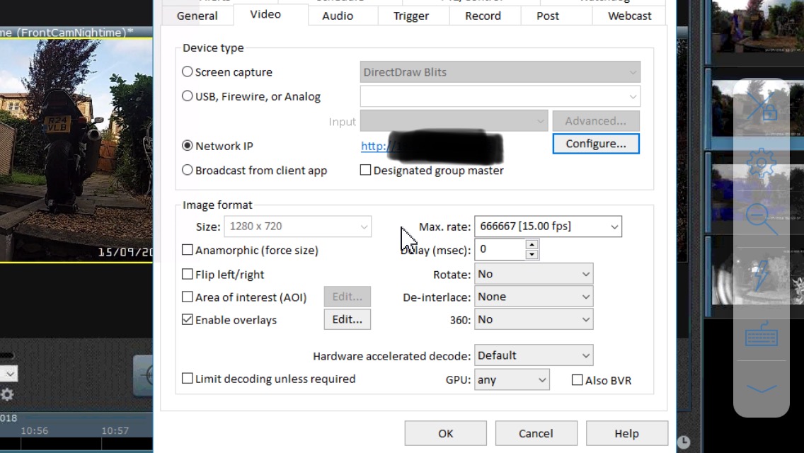

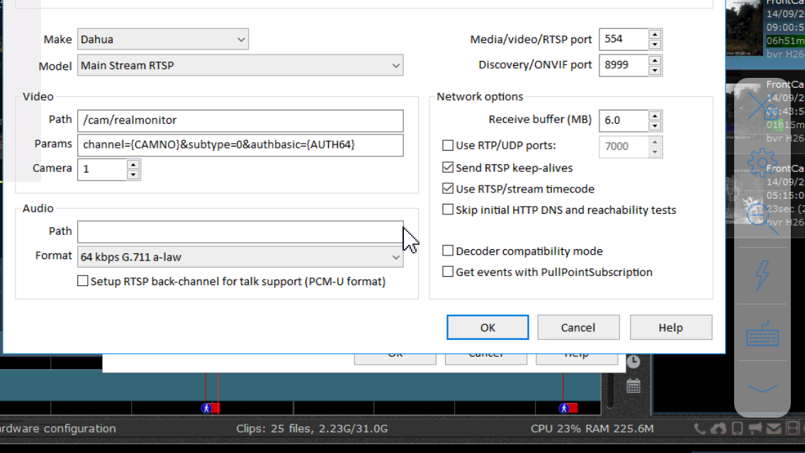

Ensure you don't have limit decoding enabled in the video settings...
Thanks for looking Fenderman, I’ve attached below all my video settings and also the camera auto detection settings, I have a
SD1A203T-GN-W , do you see anything I should change ?
Reactions: jdsfel
Yes. First, post your new zone settings...your b zone may be too small, its hard to tell from that image you posted...it could be less than that 100 pixels you set in object detection...watch the video again and set it similarly, using larger zones.

It would help if you posted a picture of the camera without the zones see we can see what the path is. It looks like there are steps with a motorcycle in the way. Not sure what areas you are trying to monitor.

In your example would the crossing rule be A-B and G would not be mentioned at all?
Correct, zone crossing rule would be A-B for both directions. Do not use G in the example I'm giving above. It's just there to keep tracking the object.
