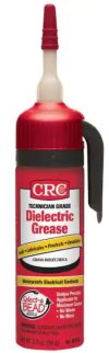

Why not come out of your camera's female pigtail with your male-terminated RJ-45, run cable out the hole, plug the hole with a plug of duct seal? Roll a ball of duct seal the size of a ping pong ball, lay it around the cable, push into the hole, with your fingers form a seal on inside and outside of the box. Be sure to use dielectric grease on the male-female connections, in and out. Do not get any of the dielectric grease in your eyes.
