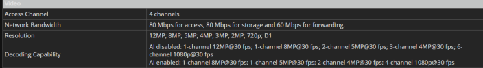

try lowering your FPS from 30 if they are maxed out. 15 is plenty. this shrinks the data thruput labor on the NVR's hardware. Also it could have 3 motion events somehow as separate clips for that guy. which might make it appear to stop start. These things are not Cray supercomputers. they barely put enough horsepower under the hood to get the job done.

To @Flintstone61 s point, these cameras are underpowered and I have experienced similar when running SMD and IVS simultaneously
