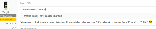

Before you do that, insure a recent Windows Update did not change your NIC's network properties from "Private" to "Public". :cool:
Is this the screen you’re referencing? Or, is there something else? If this is it, it didn’t work either. I guess windows updated. I thought I’d turned it off. Anyway, what’s done is done. UI3 works fine both ways. LAN is fine using the app. Wan still says “connecting”.
Yes, that's it.
So did you have to change it? if so, dod you re-boot the PC?
