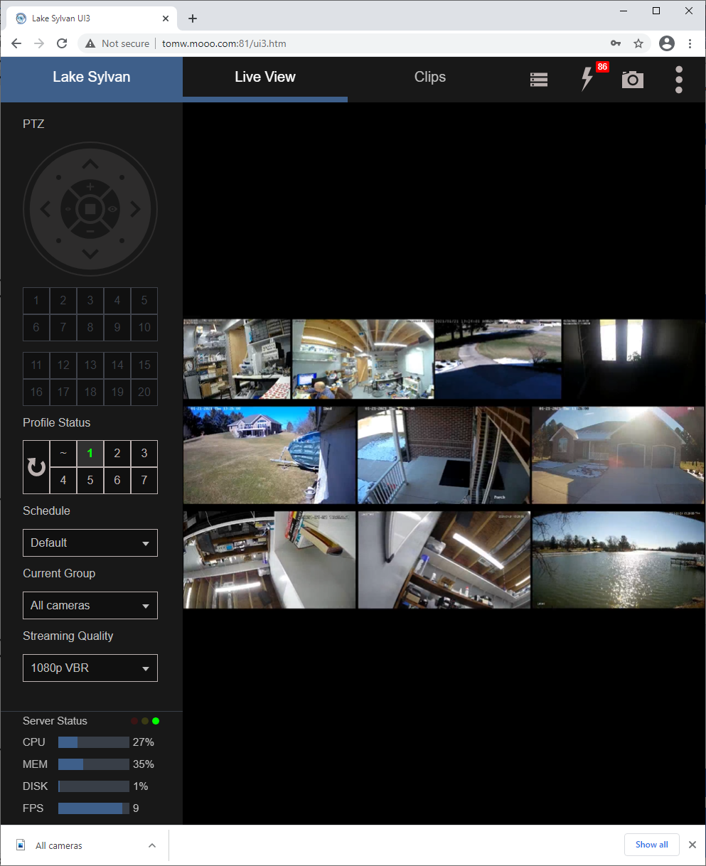

Right now the display of cameras is different using the browser than what is shown on the PC that BI is running on. On the web interface (above picture) there is 4 smaller camera rectangles across the top, the next row down has 3 (larger), the row after that has 3 (larger) as well. The PC has 3 rows of 3 each (all basically the same size), plus one on the bottom row (10 cams total).
From what I have understood from the previous posts, there is only one tab (Webcasting) that affects what the browser view will look like. Any other settings only affect what is seen on the PC screen. Is that correct?
If so, sometime in the future there possibly could be a "Browser Window Editor" where one could place and size the camera rectangles for what was desired to be seen via the browser? It seems possible. Nicer to do the arranging from the web side, but from the PC would be next best.

That is right. Once upon a time, I asked the Blue Iris developer to let UI3 specify the group frame size but he declined.
So the only way you can affect the layout is within Blue Iris's local console by rearranging cameras and changing the group frame size. These two things do affect the web interface layout, and if you get your frame size to be similar to the shape of the space Blue Iris has in its local console, then the camera layout should be the same. Details and screenshots are in that link which @TonyR posted in post #2.

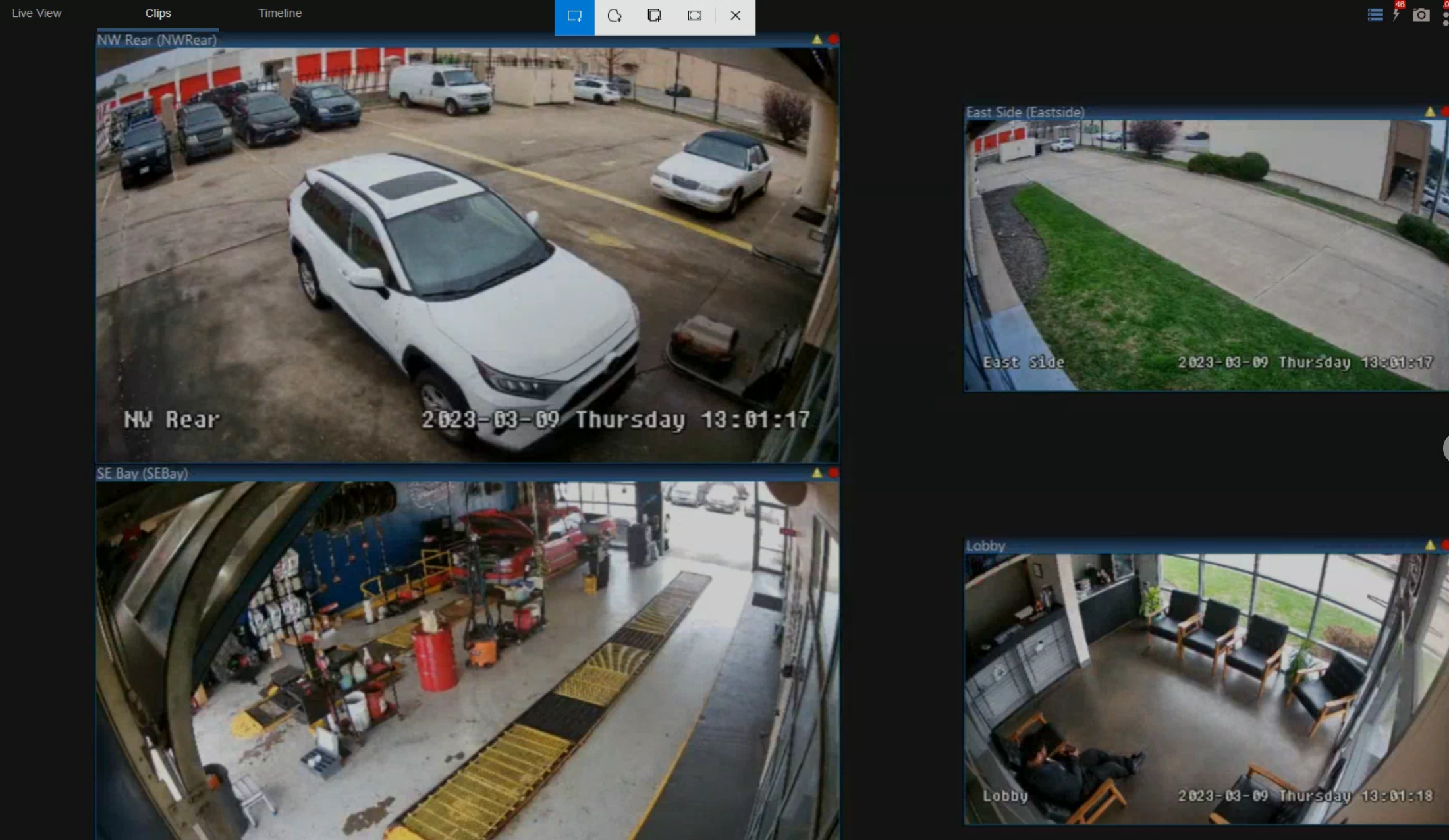

Just found this. Mine is ending up like this. As far as I can tell the Dynamic group resolution does nothing, nor does the fit to viewport. Nothing I can see in BI affects this either.
In the Blue Iris local console, choose the desired group and click the "Edit Layout" button to the right of the group selection dropdown list. Then, right click any camera to access a menu of options to configure the group layout.
You might have it stuck on a particular resolution or aspect ratio there.
