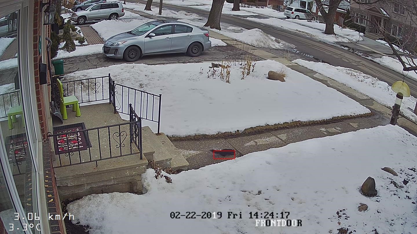

I have been trying to tweek settings to stop or at least cut down on the amount of triggers from small animals.
I have managed to knock them down a bit but not sure if I go too far I will not get triggers for people walking up to the front door.
Are you increasing the "minimum size" feature to a large value?
Reactions: Cleck and bqz
The strategy I used was making sure that "do not highlight motion" is selected, so you can play back triggered videos of the small animals with run through motion detector enabled and increase the minimum pixel size and rerun the video till the critter no longer trips the trigger. A cat is the largest animal I have filtered out, as I want to know about anything bigger. Probably other solutions, and better ones but that's what I did.
Sent from my SM-S767VL using Tapatalk
I will give this a try. ThanX
