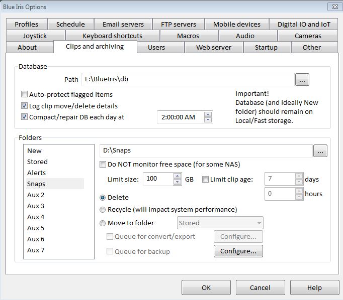

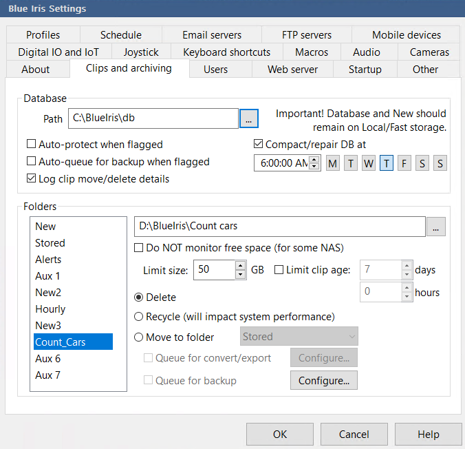

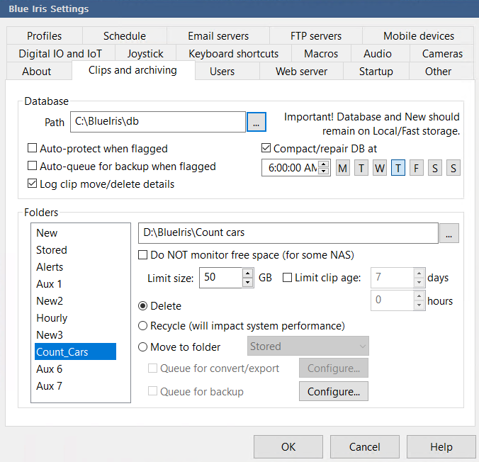

First you need to define a Folder to store the snapshots. You do that in the Blue Iris Settings/Clips and archiving tab. You need to give it enough space that it can hold lots of pics without having to delete them. See my example below.

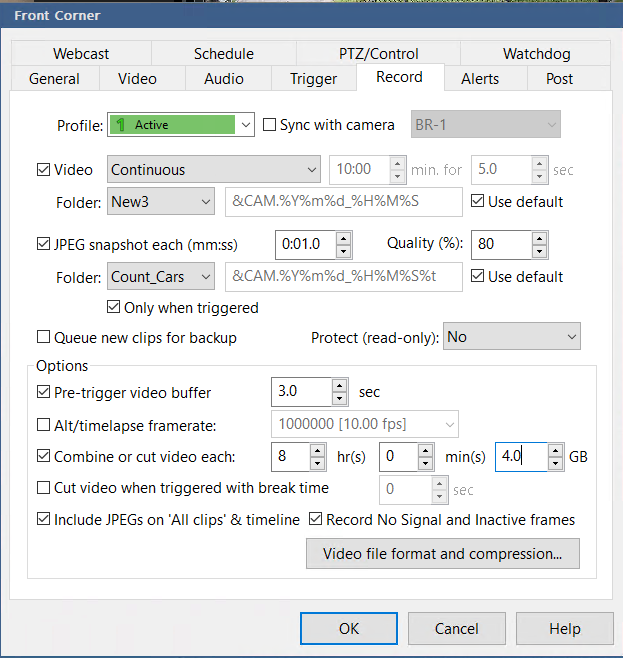

Then you need to select the proper options on the cam's Record tab, select 'Only when triggered'. Depending on how you set the timing of the snapshot and the Break time on the Trigger tab, will determine how many snaps are stored.

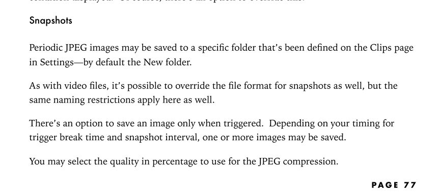

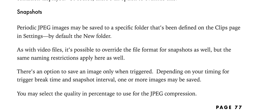

From the BI help file:

Post your menu setting of the Clips and archiving with the folder that your snapshots are going to, like my first post. And also post the display below, making sure it shows the drive you are using for snapshots.

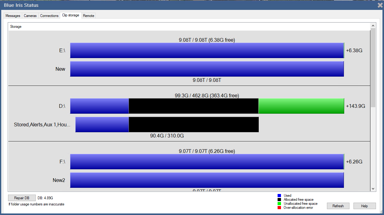

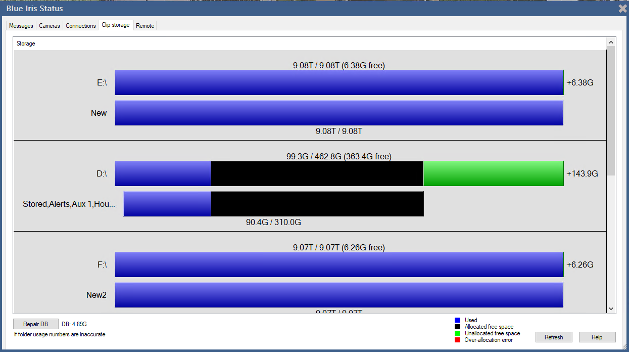

Your 'D' drive, there is 1.6TB used. What are those files? Do you have any of your cams writing video to the 'Snaps' folder? How many cams do you have?

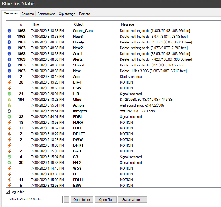

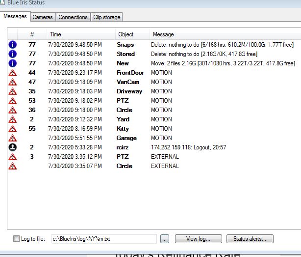

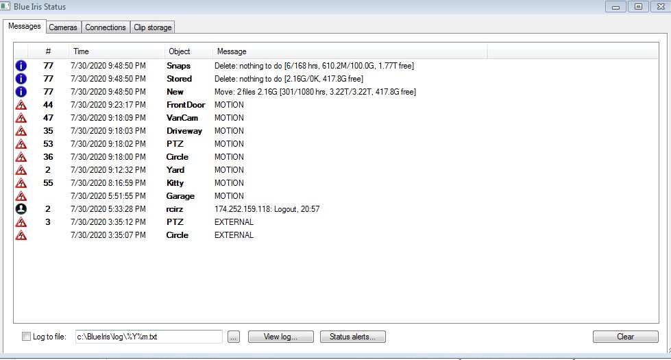

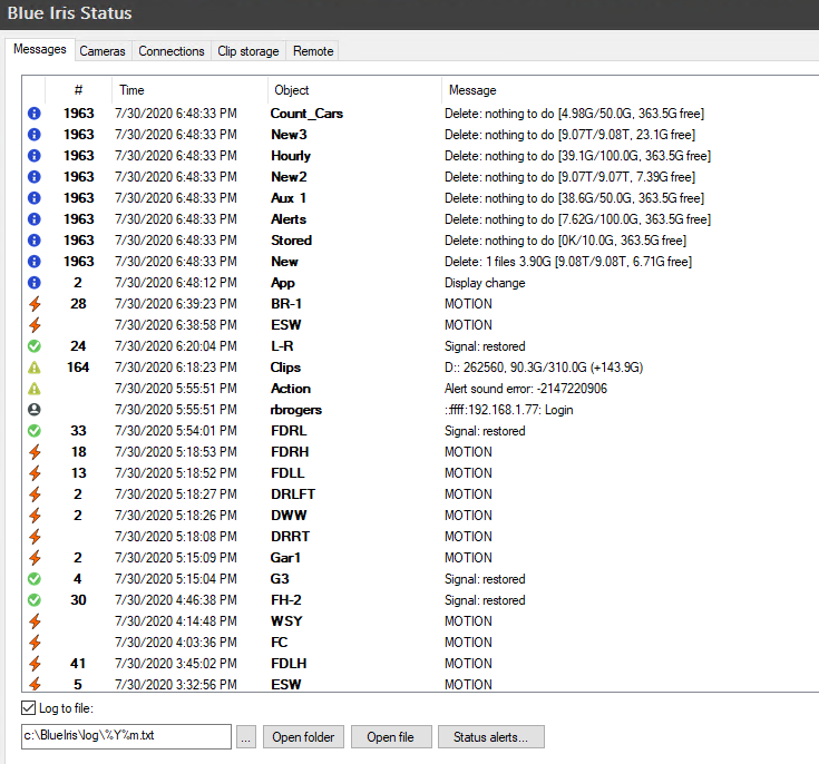

On the 'Messages' tab, is there anything telling you the files are being deleted? Maybe post that image like the one below.

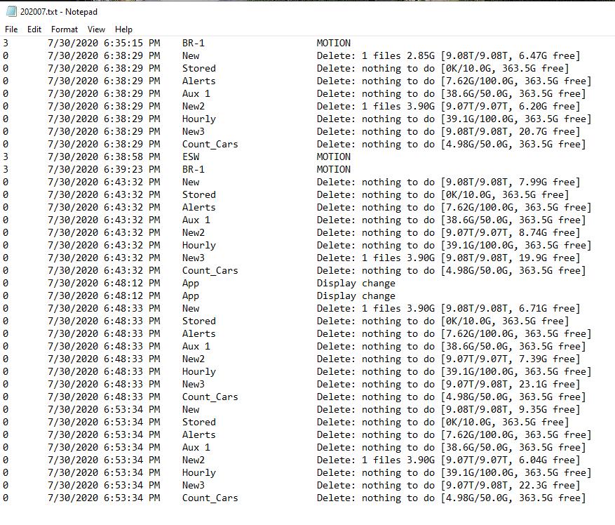

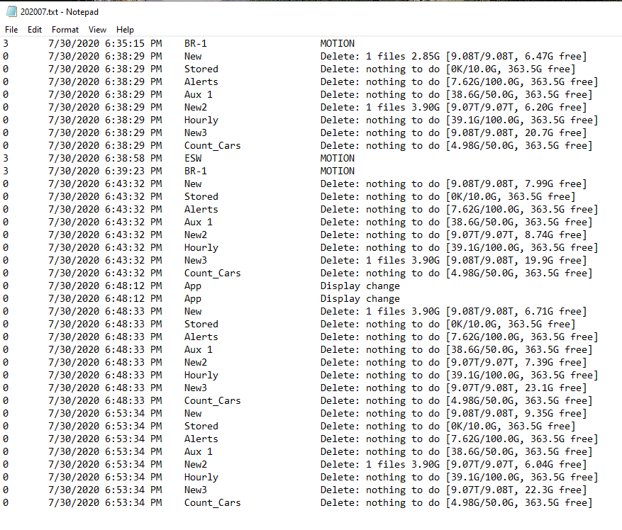

Also, on the Messages tab, click 'Open File' and scroll to the bottom (newest entries) and screen shot that like below.

D: drive is not dedicated exclusively to BI. There is only one folder "Snaps" which I set BI to write the images to. Tried changing the Snaps folder to the E drive to see if it helped. Same deal, keeps over writing last file.
I do not have the box checked to write a log file so I can't open it.

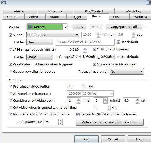

*** One clue is that the images saved do not have the time and date in the file name. Maybe since it is being named "PTZ" for example, they get over written.

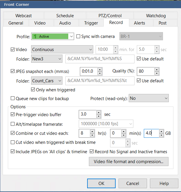

Here is the fix!!! When specifying the folder location, the syntax for date and time have to be included so written files have different names. See the image below.
I only had it as " E:\Snaps\&CAM." After adding the %H%M mumbo jumbo, files are being stored and not overwritten.
