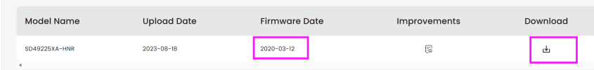

Hi. I have a SD49225XS-HNR from Andy. The camera has V2.800.1341000.0.R.P9.2520.UN.NR firmware.
Device Type: SD49225XA-HNR
System Version: V2.800.1341000.0.R.P9.2520.UN.NR, Build Date: 2020-03-12
WEB Version: V3.2.1.819501
ONVIF Version: 18.12(V2.4.5.729857)
PTZ Version: V2.401.0000000.64.RHNZ_200219_34642
Security Baseline VersionV2.0
On Dahua's web site, there are newer firmware versions :
  • DH_SD-Prometheus_MultiLang_PN_Stream3_V2.810.0000025.0.R.210317
  • DH_SD-Prometheus_MultiLang_NP_Stream3_V2.810.0000025.0.R.210317
Should I update to one of these on Dahua's web site or does Andy have a different version? If I should up date to one of the versions on Dahua's web site, which one should I use? What are the differences between PN and NP?
Thanks!
I updated to the one on Dahua's web site and now auto tracking is no longer working. "Alarm Track" is missing from rule config screen. Do we need a special firmware version to have the auto tracking feature? Thanks.
A common theme around here is don't fix what ain't broke. If the unit is working and meets your needs, in many instances an update breaks what you had working and provides you with something you didn't need. A Z12E that someone updated and then constantly reboots comes to mind, this PTZ loses autotracking with an update come to mind, a Hikvision ANPR camera losing half the FPS and ability to read US plates - those are big deals to have happen. Don't do it unless it is fixing a problem you are experiencing or adds a feature you really need.
Dahua removed autotracking from this camera...
Since you purchased from Andy, ask him for the older firmware.
Reactions: Futaba
Thanks @wittaj
Andy hooked me up and auto tracking is up and running on my 49335 again. I wonder why Dahua removed auto tracking from the camera with new firmware. Which other Dahua cameras have official auto tracking support?
