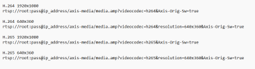

Here is what I found.
Bullet Mini LE, Done Mini LE, and Eye Mini LE all uses the same firmware.
These Companion cameras don't have a web interface, so you'd have to use AXIS Companion software to downgrade the firmware.
Official firmware can be found here.
Download firmware 8.50.1 and 7.45.1 of Eye Mini LE.
Using the AXIS Companion, downgrade the firmware to 8.50.1, then download one more time to 7.45.1. Then in AXIS Companion, factory default the camera.
Stock user is root and password is pass.
RTSP will now work if you use below links in BlueIris.
H.264 1920x1080
Code:
rtsp:/root:pass@ip_address/axis-media/media.amp?videocodec=h264&Axis-Orig-Sw=true
H.265 1920x1080
Code:
rtsp:/root:pass@ip_address/axis-media/media.amp?videocodec=h265&Axis-Orig-Sw=true
H.264 640x360
Code:
rtsp:/root:pass@ip_address/axis-media/media.amp?videocodec=h264&resolution=640x360&Axis-Orig-Sw=true
H.265 640x360
Code:
rtsp:/root:pass@ip_address/axis-media/media.amp?videocodec=h265&resolution=640x360&Axis-Orig-Sw=true
Reactions: bp2008
