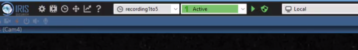

Hello and good day,
I m new to blue iris and need some help with schedule and profiles. I want to record only from 1am to 5 pm. This is what I set up but its still recording 24 hours ( indicated by the red dot )
What am i missing?
Thanks
Jan
It says you are drawing the profile for 1 Active (in green) but editing "recording1to5"
So make sure you in the right one. Probably make sense to create a profile not to record also.
Then in the Record tab, make sure you are recording just the correct profile.
