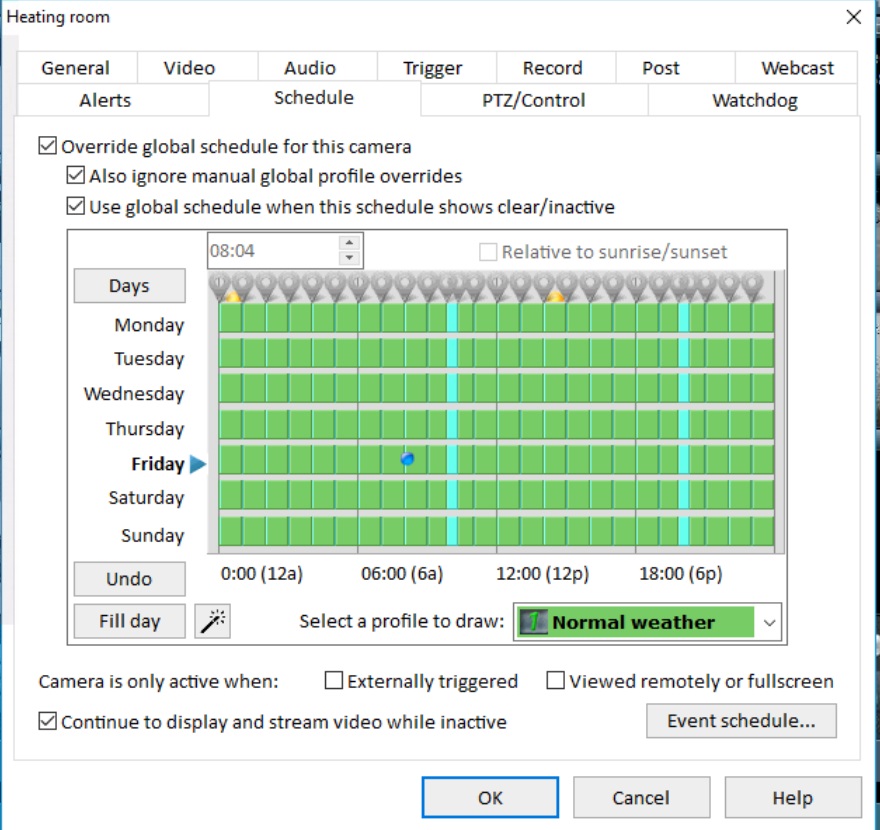

hmmmm , not so easy .
On the camera which just needs to record twice a day and for about half an hour , and than on motion trigger, I made an extra profile (7- Record, the other profiles are set to motion detect) , and made a schedule for that with overiding everything. That worked. Only thing is , it is recording from xx:55 untill xx:25, it show in the android app as 2 different videos cuts it exactly on the hour, any idea how I set it , that is is recorded as 1 video?
All my other cameras are set at "cut every hour" , see attachment 3. I think there might be the issue.

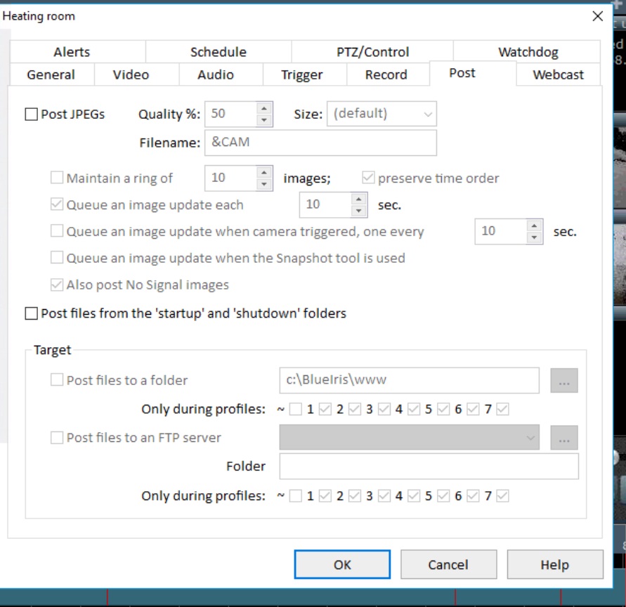

The other camera, which needs to make a snapshot every hour, not so succesfull. You said to use the post function , but how do I set there the time when the snapshot should happen? I want a snapshot every xx:05.
I just tried to make every hour a small video, so I made 24 schedules of 1 minute. This probably works as well. ( see attachment 1 and 2)
Thanks,
Cor

You dont need to use the post function at all. Just set snapshots up in the record tab.
