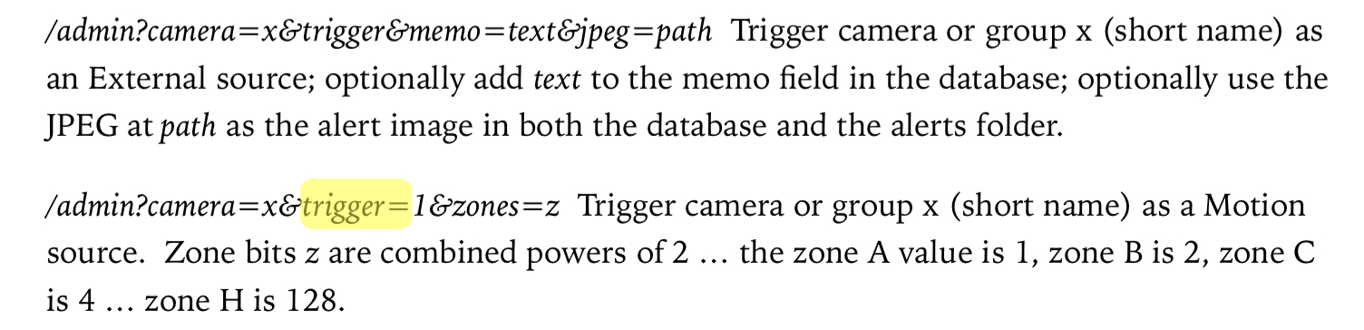

I’m not clear on your goal, but i think the syntax is incorrect for triggering as a Motion source.
Try trigger=1
Furthermore, I think trigger=1 goes through Sentry, and will not trigger if no human is detected. Not an issue, I think, if you’re not a user. Edit: just tested 5.3.9.16 and currently triggers actions regardless of Sentry.
From the help pdf
