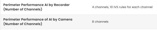

You do not want to use the AI in the NVR unless the camera doesn't have AI as using the NVR AI cuts the capabilities of the NVR by at least half.

I would just like to ask you again about "You do not want to use the AI in the NVR unless the camera doesn't have AI as using the NVR AI cuts the capabilities of the NVR by at least half".
What capabilities do you mean?
