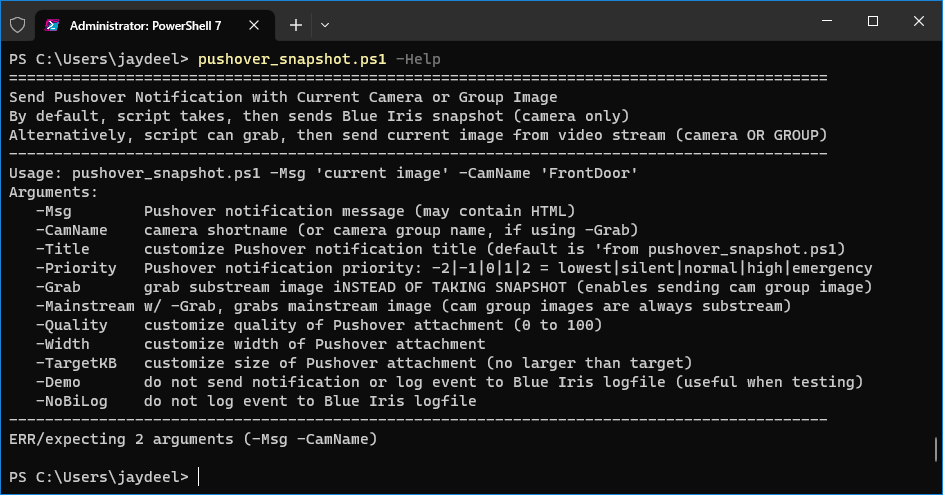

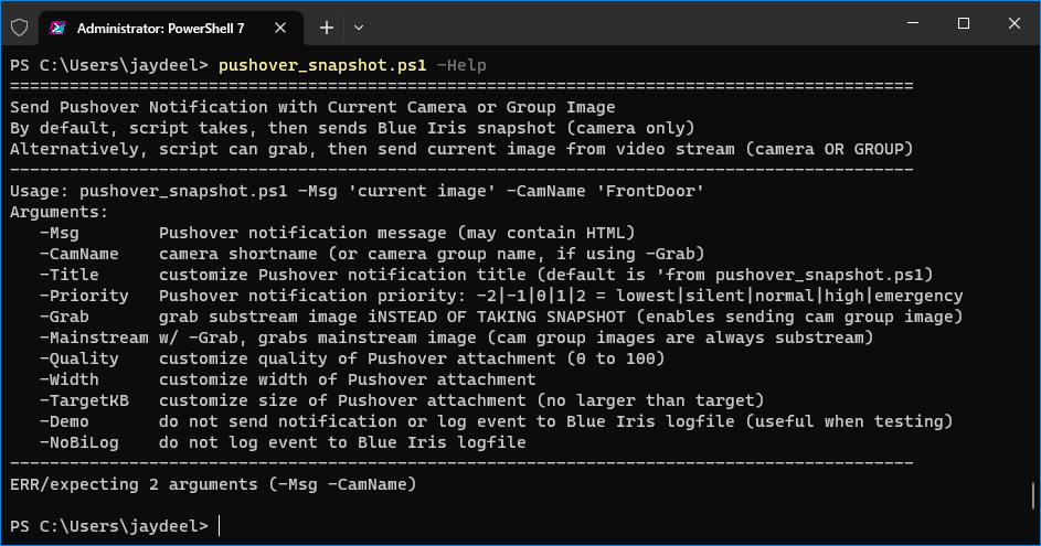

Here's a screenshot of all arguments available in the script:
pushover_snapshot.ps1 -Help

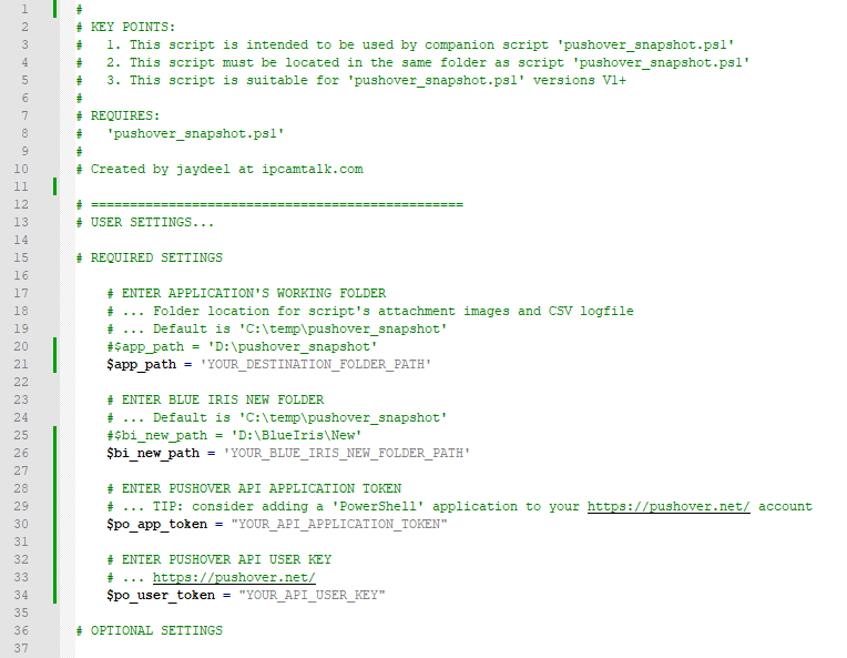

STEP #2:
Edit the user settings file

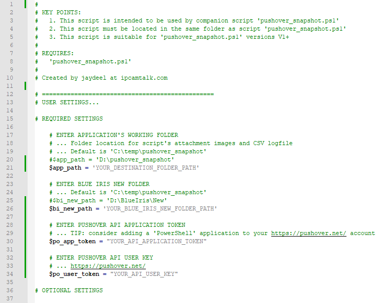

  1. The user settings file is named 'pushover_snapshot_user_settings.ps1'?
  2. Open the file in a code text editor (I use Notepad++)
  3. Edit the REQUIRED variables in the USER SETTINGS section (see screenshot)
  4. Ignore the remaining settings for now. They provide customizations that you may want to explore later.

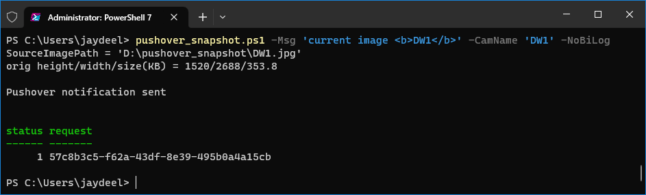

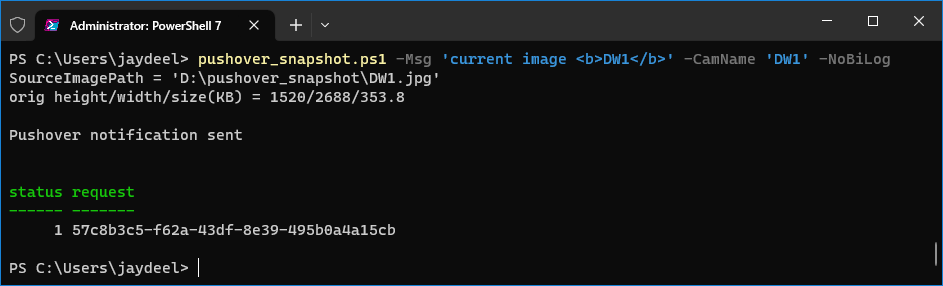

Test the script from the console
  1. Open an Admin PowerShell window, or Powershell-ISE window
  2. Select and copy each of the the following commands and paste it into the console (one at a time)
    pushover_snapshot.ps1 -Msg "current snapshot" -CamName "DW1"
    pushover_snapshot.ps1 -Msg "current stream grab" -CamName "DW1" -Grab -Mainstream
    pushover_snapshot.ps1 -Msg "current stream grab" -CamName "Index" -Grab
  3. Edit 'DW1' to match the short name of one of your cameras
  4. Hit the Enter key.
The response should look like following screenshot​

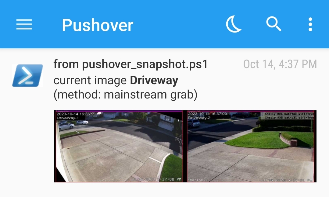

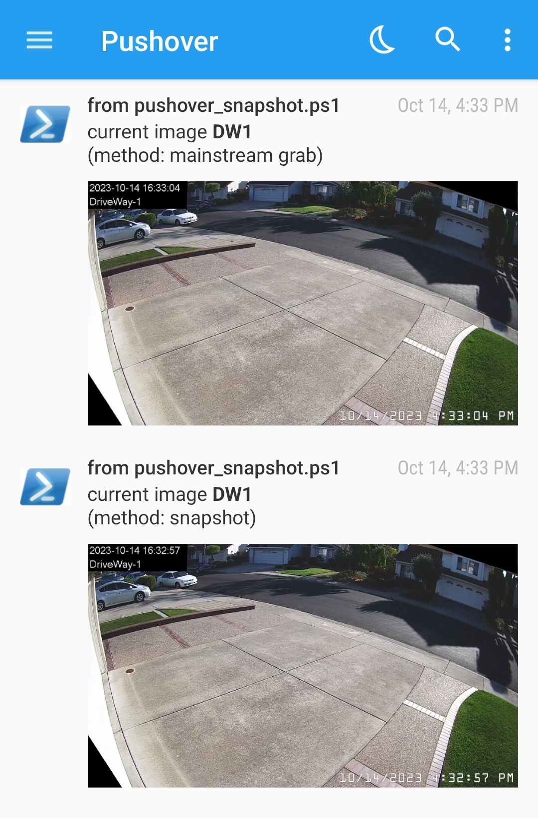

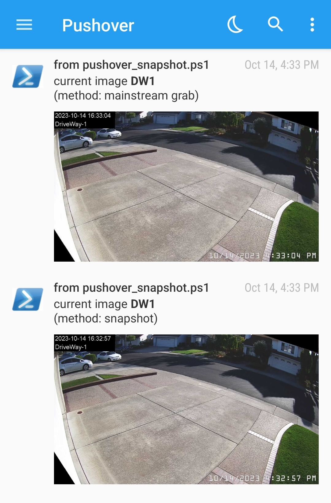

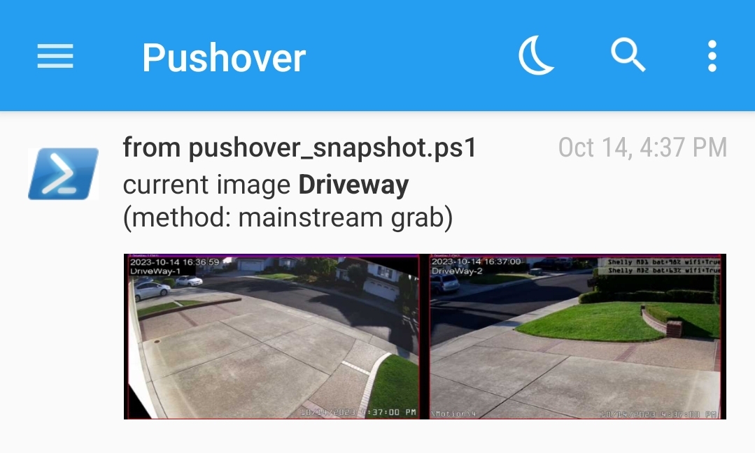

You should also receive your first Pushover notifications from the script, like these examples:​

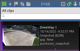

And the first command in #2 above should show a new entry in the cliplist, like this​

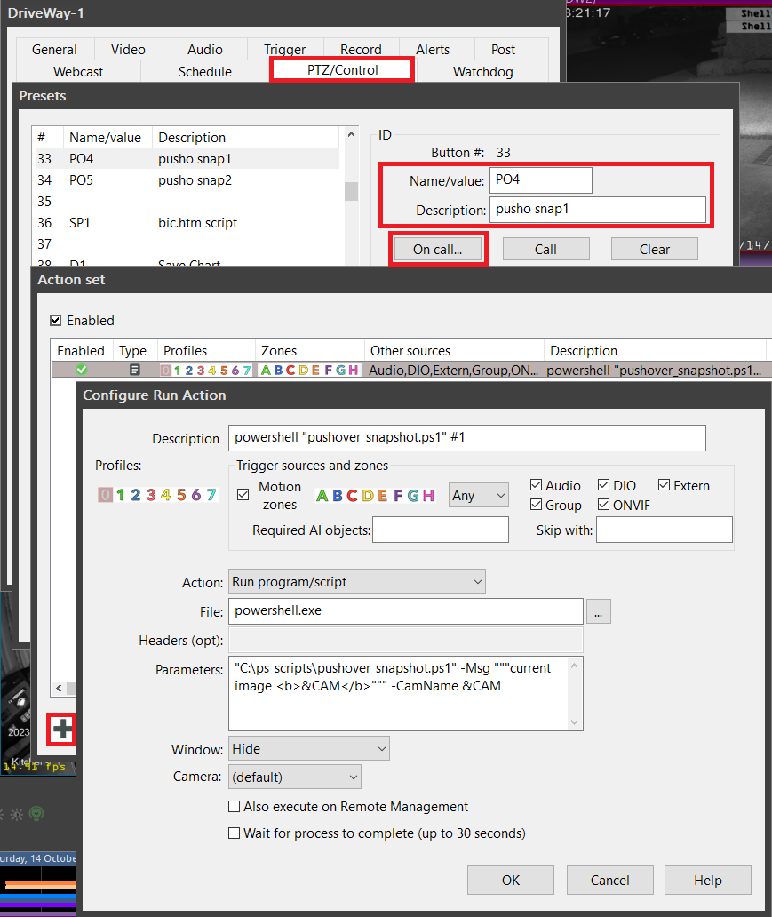

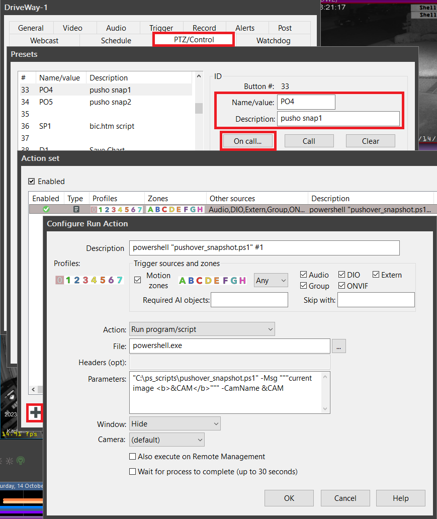

Test on a on a camera Preset
  1. Click 'Camera settings' > 'PTZ/Control' tab
  2. Click 'Edit Presets..." to open the preset editor

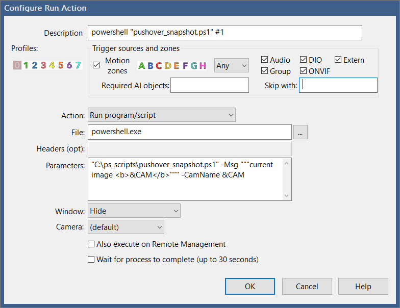

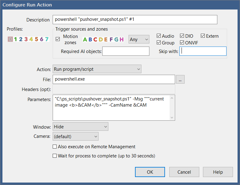

  3. Create a new 'Run a program' action, and configure it as shown in the following screenshot
The code for the 'Parameters' field is like the following:​
"C:\ps_scripts\pushover_snapshot.ps1" -Msg """current image <b>&CAM</b>""" -CamName &CAM
"C:\ps_scripts\pushover_snapshot.ps1" -Msg """current image <b>&CAM</b>""" -CamName &CAM -Grab -Mainstream
Please note that the triple double quotes (""") in the -Msg parameter are ESSENTIAL.

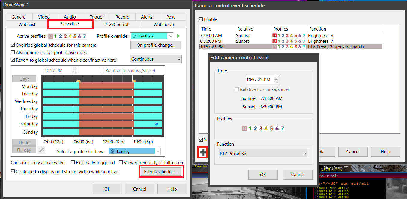

Send camera / cam group image notifications on a schedule
In the Blue Iris console...​
  1. Select a Camera
  2. Click Camera settings > PTZ/Control > Edit Presets
    Set up a preset to execute the pushover_snapshot.ps1 script (see screenshot below)

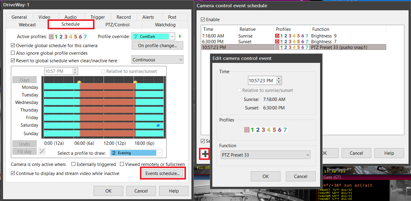

  3. Click Camera settings > Schedule > Events schedule
    Setup an event to execute the preset in #2 (see screenshot below)
Screenshot - Step 2​
Screenshot - Step3​

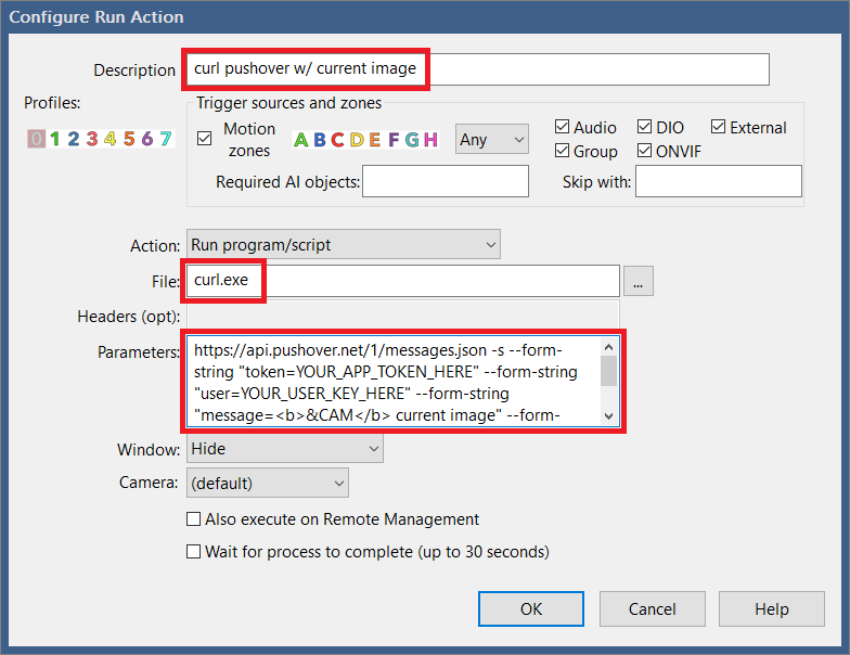

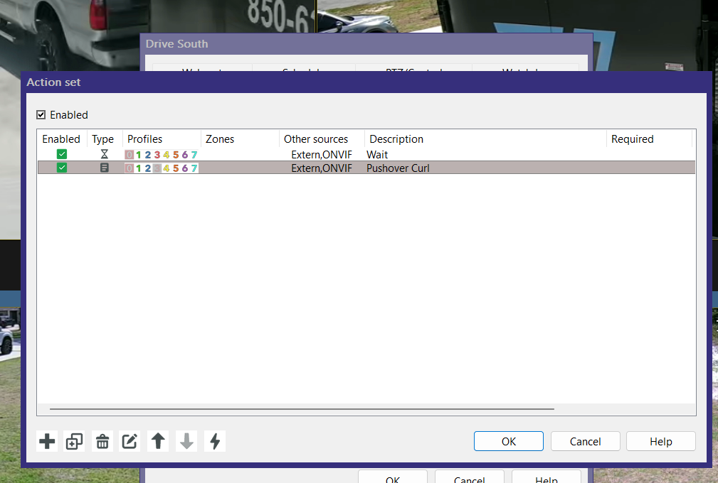

As of update 5.8.0.9 (more details), Ken has add a new macro to Blue Iris, &IMAGE_PATH
This new macro can be used to send Pushover notifications with a CURRENT image of the camera.
For example, try the following in a Blue Iris 'Run a program' Action:
Here's the code for the 'Parameters' field:
Code:
https://api.pushover.net/1/messages.json -s --form-string "token=YOUR_APP_TOKEN_HERE" --form-string  "user=YOUR_USER_KEY_HERE" --form-string "message=<b>&CAM</b> current image" --form-string "html=1" -F "attachment=@&IMAGE_PATH"
This new macro is simpler to use, though less flexible, than the script in post #1.

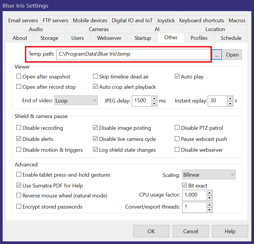

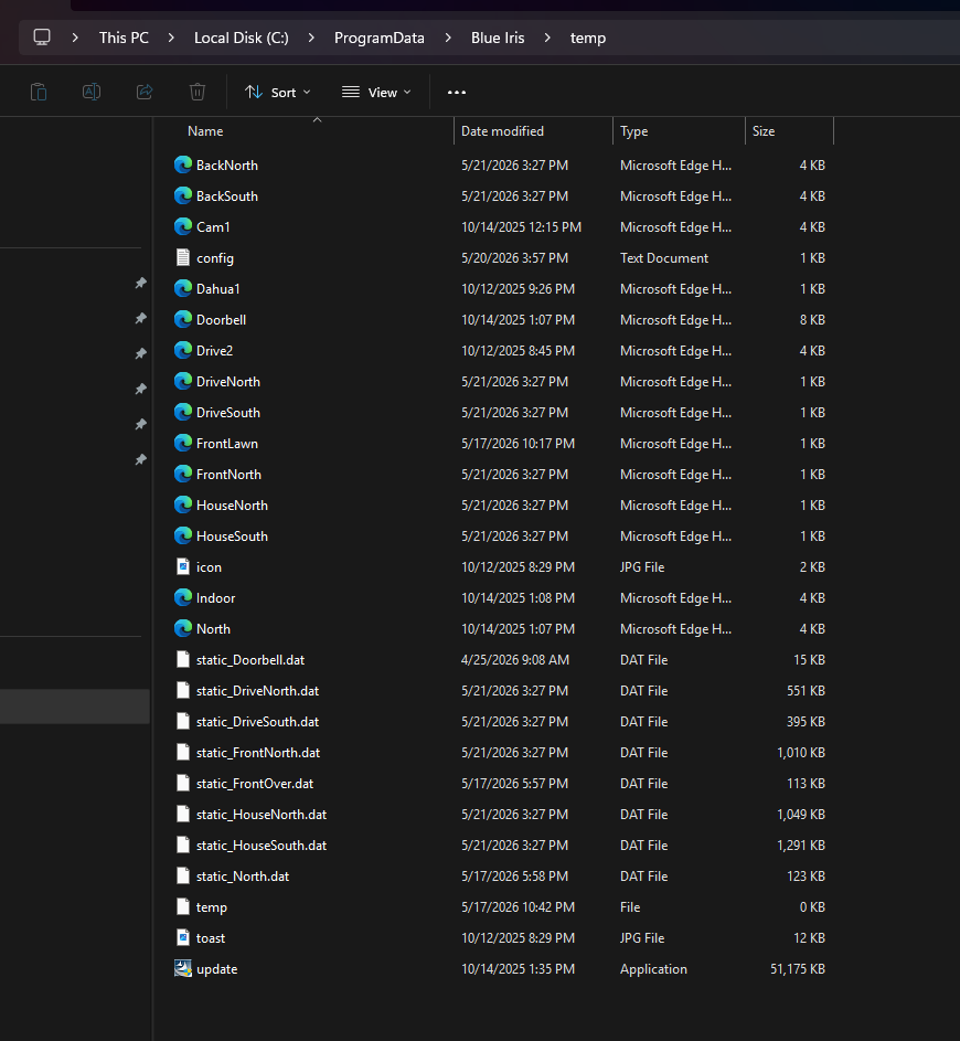

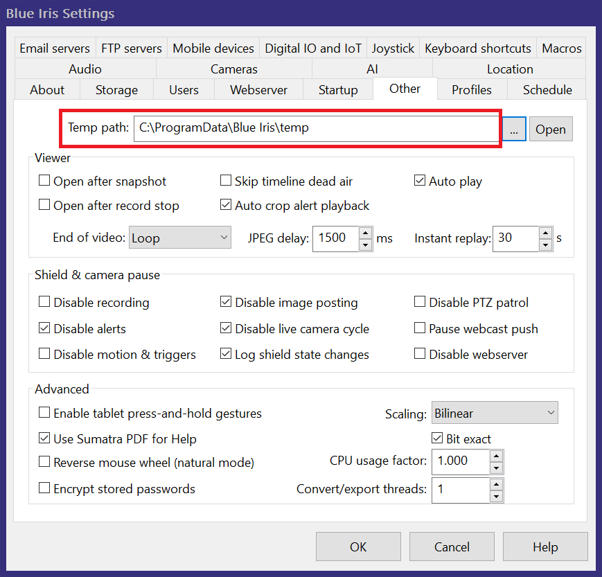

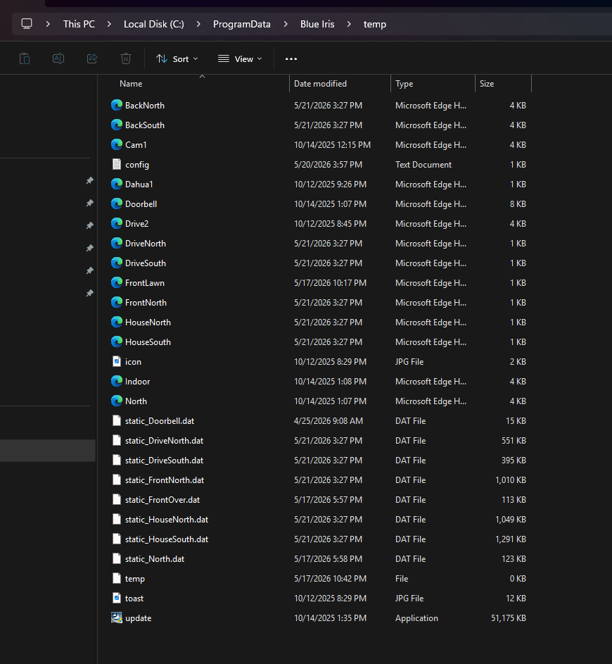

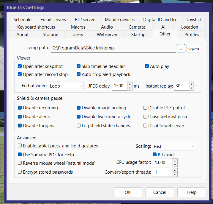

The &IMAGE_PATH file resides in the Blue Iris temp folder (C:\ProgramData\Blue Iris\temp) -- as described in this post.
