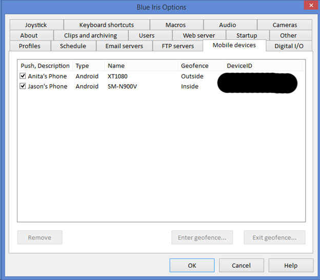

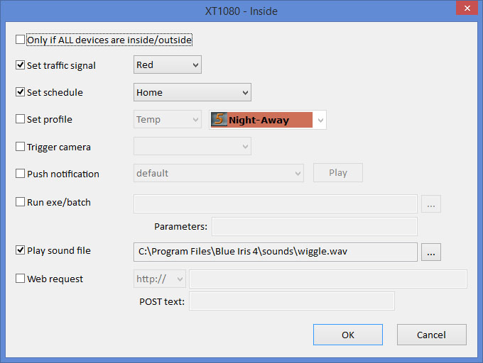

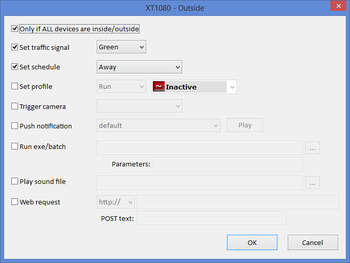

Here's my screen shots of how it's setup:
attachment.php
Anita Enters Geofence:
attachment.php
Anita Exits geofence (mine is setup the same):
attachment.php

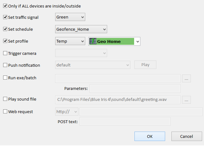

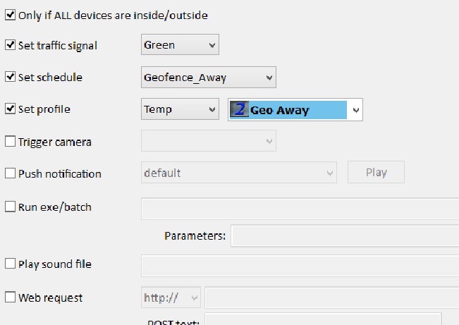

Here is what i have set up for one camera and one iphone 5 (untested)
2 Schedules: Geofence Home, Geofence Away
2 Profiles: Geo Home, Geo Away
2 sets of presets one for home and one for away
when i enter the Geofence it should be on Geofence Home / Geo Home / Preset set 1
when i exit the Geofence it should be on Geofence Away / Geo away / Preset set 2
Geofence set to 400m and update notifications set to on (iphone 5s)

@Caspy,
You dont need separate presets for a basic setup like that...it just complicates things...
Also note that you have the profile change set to temp...that should be set to hold if you want to keep that profile until you leave or manually change it...
Reactions: Caspy
Cheers for the tip on the temp / hold thing.. i had and stil have no idea what its for but changing it seemed to work.. Did a quick test this morning when dropping th kids off at school.. all seemed to work as its ment.. changed to away when i left and to home when i got back.. just need to tidy up the settings and we should be good to go.
