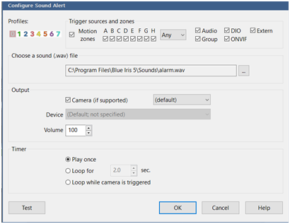

I tried the ON ALERT Feature to trigger the T5241 and it will trigger it to start recording, which is good. Probably expecting to much for it to also play the sound from that camera during a trigger from BI - is it even possible?
So I thought maybe I could also set up an ON ALERT for sound, but nothing comes out of the camera speaker when testing or triggering.
Has anyone had success playing a sound from an internal speaker on a camera?
I am getting the camera to play a sound file from Blue Iris On Alert events, but it can be intermittent.
What u have above should work. Setting the sound to play for 4 seconds or more seems to have better success.

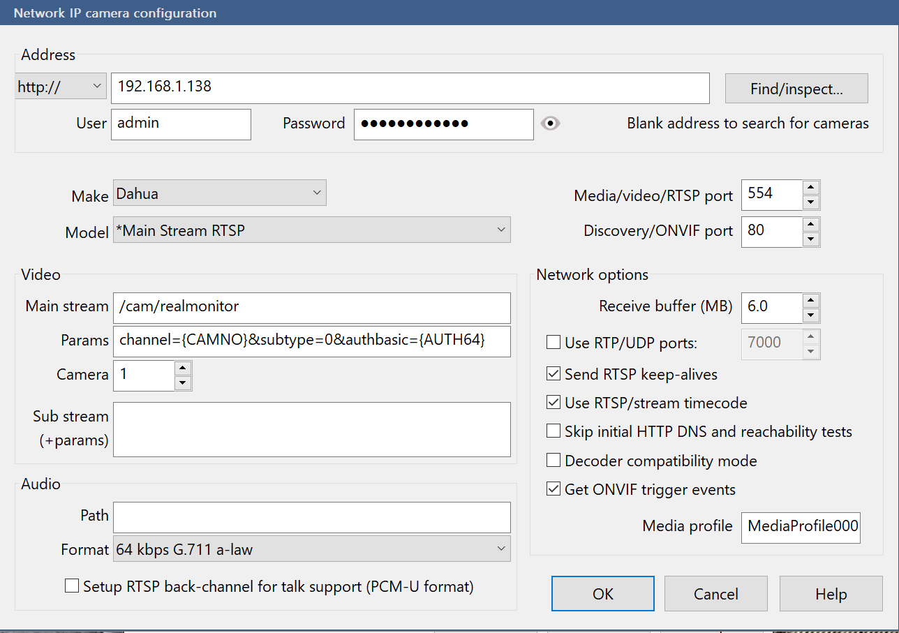

Attached is my current config in BI and it works with a delay and not always.

Yeah, I have the same settings you do for the add camera screen.
