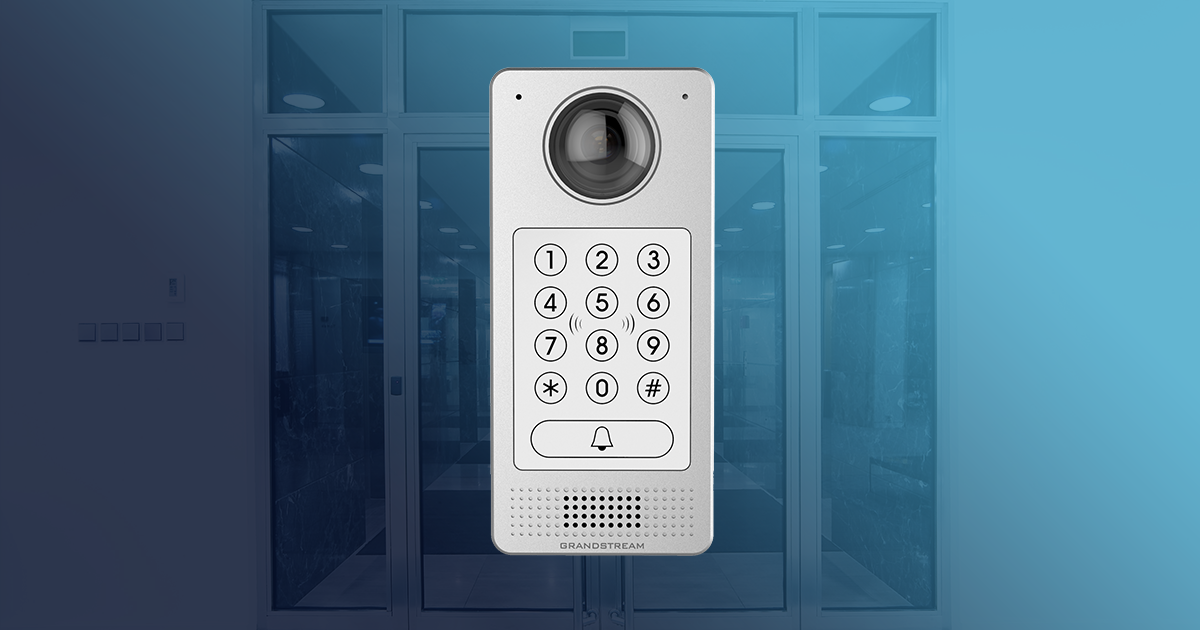

Looking for a recommendation for outdoor doorbell.
Requirements:
  1. Water proof (since it is outdoor and will get wet/sun)
  2. Camera/intercom is nice to have (but not mandatory)
  3. Preferably option to integrate with smart home (to know when the door is open/closed or disable lock)
  4. Budget - 150 USD (ignoring shipping costs).
This seems like a good fit, but don't know if this brand is reliable.

The main reason for wanting this doorbell is to prevent people who don't live in the property to get into the yard (this is not an apartment building) - so the camera/cloud are less important here.

Thanks for the extra information. It really helps narrow down exactly what you are looking for. It sounds like a door station is definitely what you are looking for.
Something like the grandstream would work well. While I don't have experience with that particular model, I do use a few Grandstream digital phones and they work well. Of course to control access to the gate, you are going to need to get a magnetic lock for the gate as well as some sort of exit control when you want to leave your property. It might be a simple push button if you can locate it away from the fence/gate so it isn't close enough to be pressed from outside the property. If it has to be mounted close, then another keypad where you have to enter the correct number to activate the lock would work. However that grandstream model seems to have the correct I/O to work with a magnetic lock for access control. It also has both RTSP feeds and SIP compatibility which means it can tie into a larger CCTV system and/or digital phone system/intercom.
It's a little higher than your budget, but I would be shocked if you can find a door station in your price range. After all, a door station has a lot more components and circuitry than a video doorbell, and most video doorbells are in the $100-150 price range. A good quality door station is going to cost more.

What @fenderman suggested looks good: GDS3710.
I just wonder how to use it, since it should control a door latch, so is it included in this kit (i'm totally new to this)?
About the price I just saw that a similar product costs about $500 (where I live), so, I will probably need to adjust my budget.
